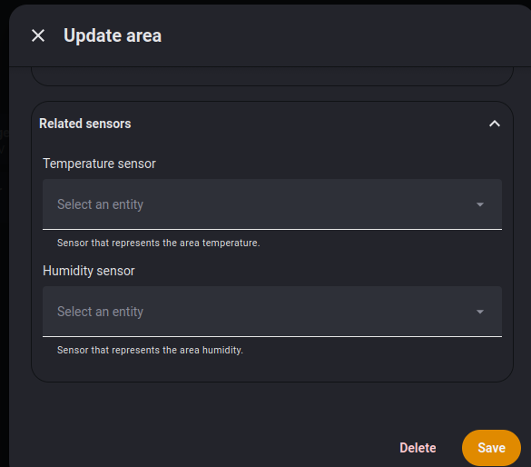

For each Area dashboard click the pencil icon at the top right to edit its settings, at the bottom there is a section called "Related Sensors" where you can assign 1 sensor of each type to act as the representative for that area. Then they will also appear in the Climate dashboard.
Excellent!!! Thanks!
