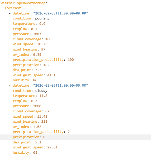

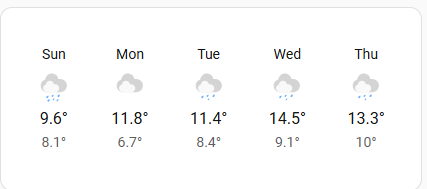

It seems to use the temperature and templow on my openweathermap integration.
But you have to run daily check, now hourly. When I test for hourly, I don’t have the templow in response.
Yep, shitty weather :slight_smile:
Yes,
in weather forecasts, hourly entries are normally seen as point-in-time entries, not as time-ranges like the daily entries.
(Which is technically not correct, but an hourly forecast based on these models is already inaccurate enough.For more fine grained values of the next 1 or 2 hours of clouds/rain you could look for a so-called radar based “nowcast instead”. But for temperature the hourly forecast values are the best you will get.)
So there is only a single temperature for hourly forecast items, but a range (temp and temp-low) for daily forecast items.
