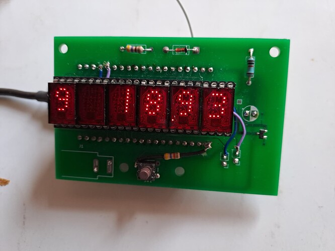

I created a clock using an ESP32 and some old HP 5082-7300 digital displays to show HH.MM.SS . It took the time from NTP over a Wifi connection.
It would be useful if it was migrated to HA so maybe other things could also be displayed.
The displays use BCD latched data. It was relatively simple in Arduino to create an unsigned long value (E.G. for 12: 45: 00 = 124500), then bit shift and latch to each display.

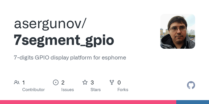

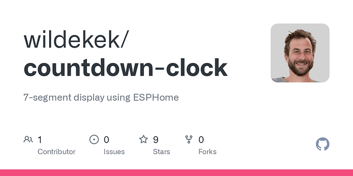

This is a 7-segment display, but uses a different interface.
A clock with interface to raw 7-segment display
An external component for raw 7-segment display:
external components replace custom components. They require the developer to do more so the user has to do less.
https://developers.esphome.io/architecture/components/

Update:-
I retained the ESP32 BCD code handling in Arduino IDE land and then added MQTT. So now I can send the time and various temperature values from HA to be displayed.
To me, that was a lot easier than trying to write in ESPHome speak.
Needs a case now.
