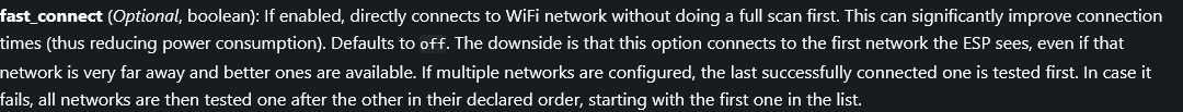

Try using fast connect in the wifi settings. That may shorten the delay.
https://esphome.io/components/wifi/
Yea I’m already using that. I guess the unpredictable delay may come from how often HA loops to detect the status of the device? Both online and offline case.
