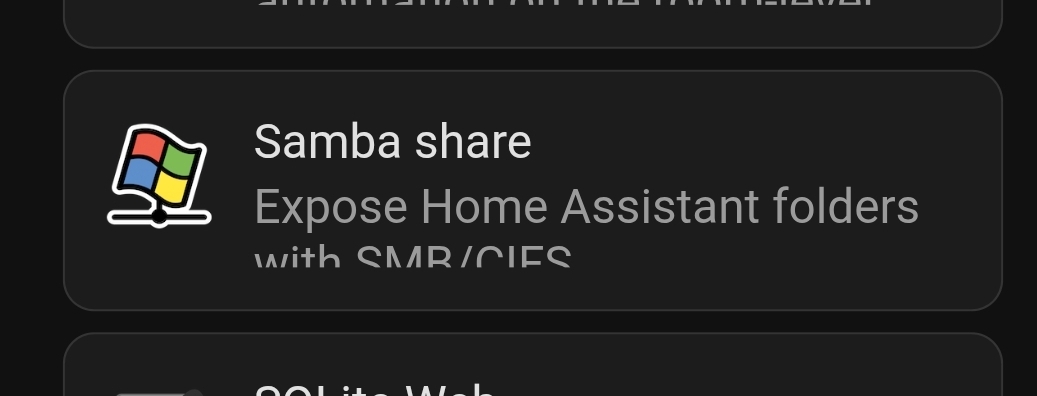

HAOS and use the Samba SMB 'App' and share your files there.
