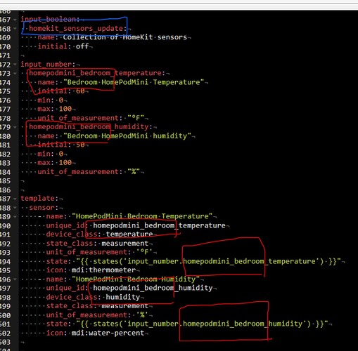

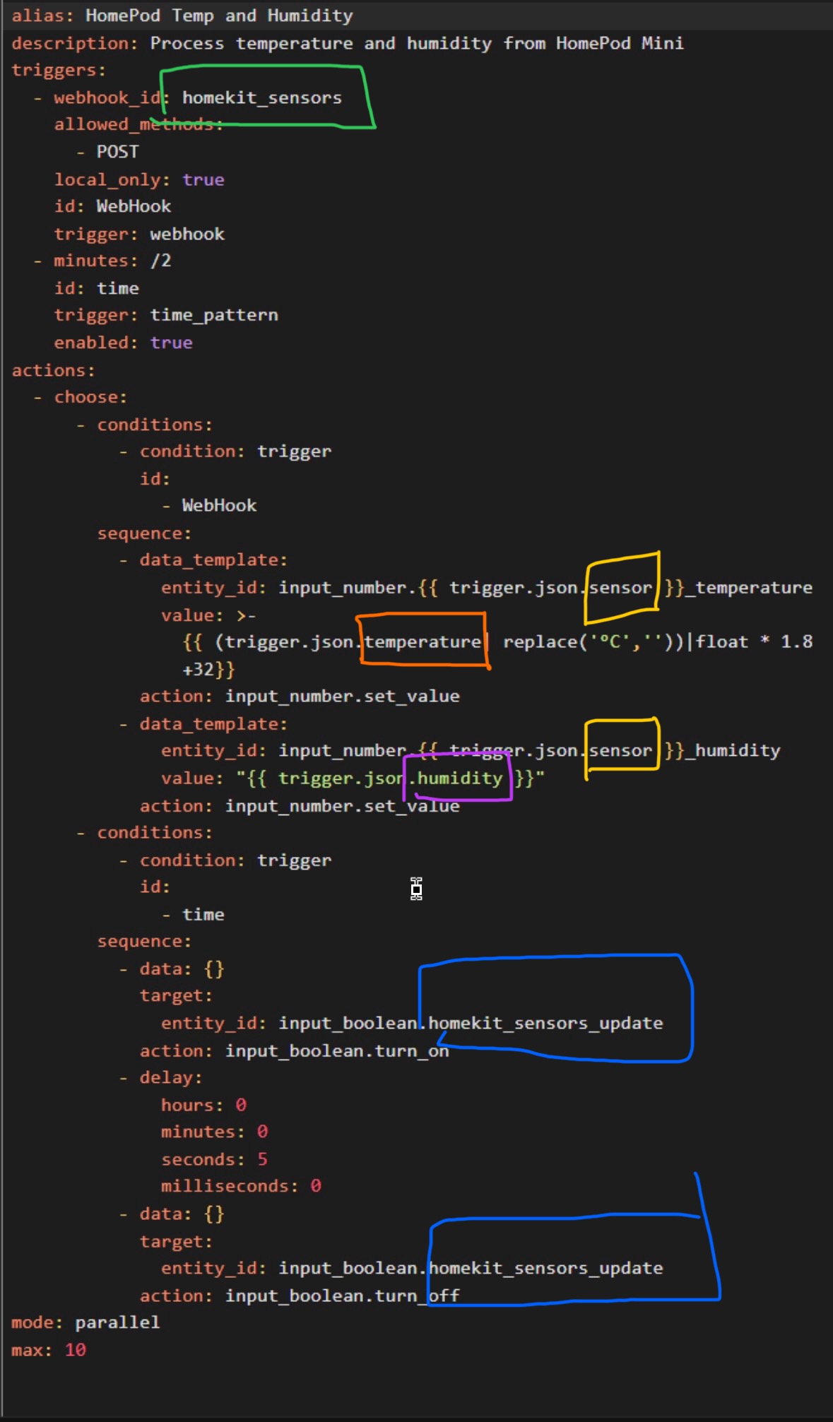

Had a little trouble getting it to work until I figured out which parts posted corresponded with other parts. Other hurdle I ran into was the homepod by default sends the temp as a string with °C in it so my automation strips it to just the number then converts to fahrenheit. Not near a computer so phone screenshots for you. Colored boxes all correspond to parts that match across the Shortcuts app automation and Home Assistant’s automation.
At a desktop now, here’s my automation yaml:
alias: HomePod Temp and Humidity
description: Process temperature and humidity from HomePod Mini
triggers:
  - webhook_id: homekit_sensors
    allowed_methods:
      - POST
    local_only: true
    trigger: webhook
  - minutes: /2
    trigger: time_pattern
    enabled: true
actions:
  - choose:
      - conditions:
          - condition: trigger
            id:
              - WebHook
        sequence:
          - data_template:
              entity_id: input_number.{{ trigger.json.sensor }}_temperature
              value: >-
                {{ (trigger.json.temperature| replace('°C',''))|float * 1.8
                +32}}
            action: input_number.set_value
          - data_template:
              entity_id: input_number.{{ trigger.json.sensor }}_humidity
              value: "{{ trigger.json.humidity }}"
      - conditions:
            id:
              - time
        sequence:
          - data: {}
              entity_id: input_boolean.homekit_sensors_update
            action: input_boolean.turn_on
          - delay:
              hours: 0
              minutes: 0
              seconds: 5
              milliseconds: 0
          - data: {}
            action: input_boolean.turn_off
mode: parallel
max: 10
And input helper yaml:
input_boolean:
  homekit_sensors_update:
    name: Collection of HomeKit sensors
    initial: off
input_number:
  homepodmini_bedroom_temperature:
    name: "Bedroom HomePodMini Temperature"
    initial: 60
    min: 0
    max: 100
    unit_of_measurement: "°F"
  homepodmini_bedroom_humidity:
    name: "Bedroom HomePodMini humidity"
    initial: 50
    min: 0
    max: 100
    unit_of_measurement: "%"

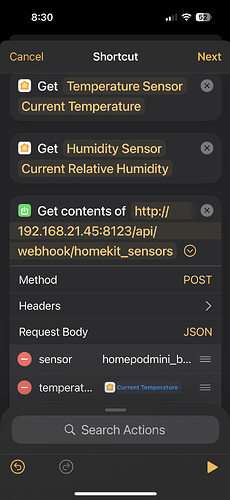

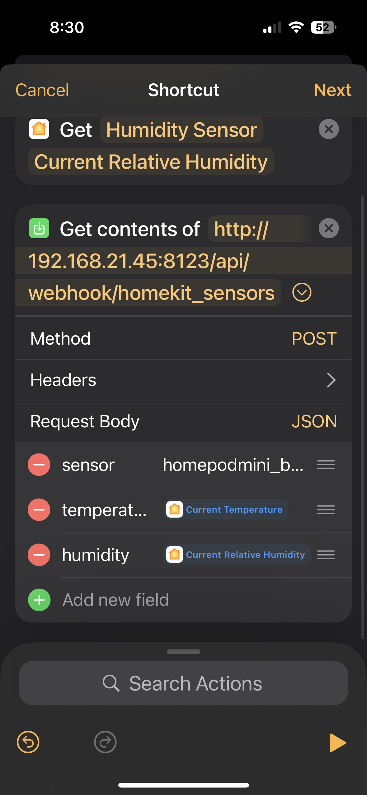

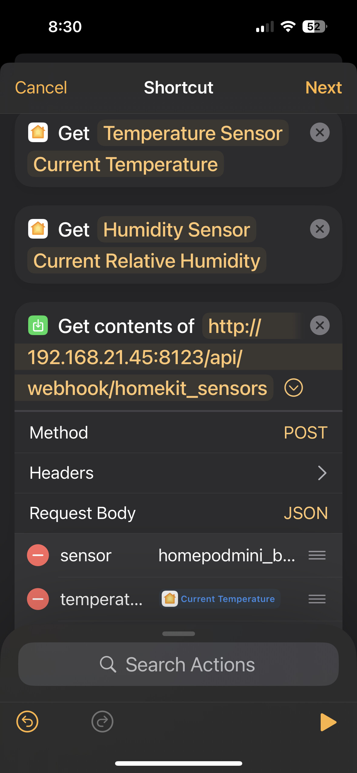

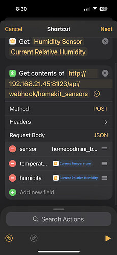

Hi, I’m doing method B and I’m stuck on step 3.
Where do I add these JSON? When I get to the stage where I convert the automation to a shortcut, I don’t seem to see the temperature of humidity exposed.
Could someone please provided clearer steps? Thank you
Look at their picture directly after that. It’s in the Headers section for your step in the shortcuts app: “Get contents of http://homeassistant:8123/api/webhook/{WEBHOOK_ID}”, with WEBHOOK_ID being “homepodmini_temperature” in their picture. Headers is directly below Method, and directly above Request Body in that Shortcuts action.
To get the authorization token you need to put there, go to your Hass in a browser, click your user at the bottom of the sidebar, go to the Security tab, and scroll to the bottom section Long-lived access tokens. Then create a token. That token is what you’d put in that Headers key that you’ll name Authorization, with the format “Bearer {TOKEN_HERE}”. There’s a link there in that long lived access tokens section with documentation on making authorized POST requests.

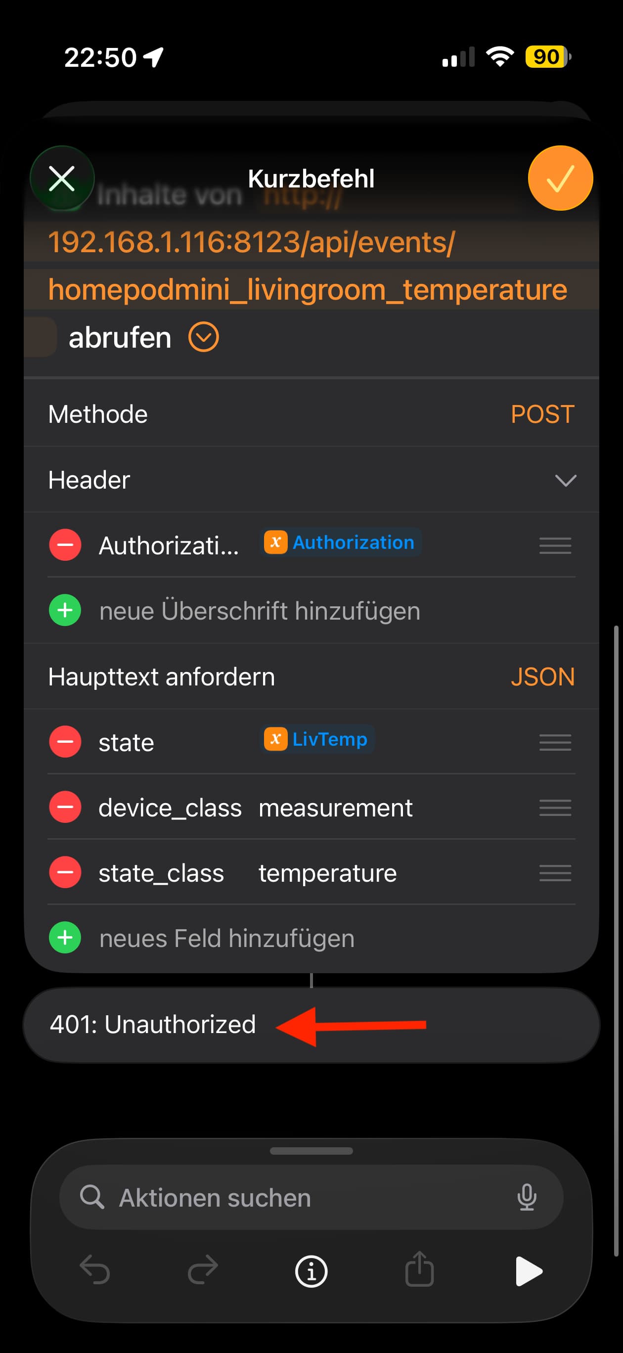

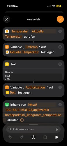

Hi there
First of all thanks a lot for the nice article. I would describe myself as a more or less experienced HA-user, however I cannot get this thing to run :frowning: I spent several hours including reading this whole thread and asking Chat GPT.
UPDATE: I have created like the 4th token and now it works like a charm :slight_smile:
Here is what I have configured so far:
template:
  - trigger:
      - platform: event
        event_type: homepodmini_livingroom_temperature
    sensor:
      - name: "Livingroom Temperature"
        unique_id: homepodmini_livingroom_temperature
        state: "{{ trigger.event.data.state }}"
        unit_of_measurement: "°C"
        device_class: temperature
        state_class: measurement
Home-App automation looks like:
As you can see I get an 401:Unauthorized error. I created 3 new API long-living keys, however none of them works.
I payed extra attention on the text-field: Bearer eyJh… (only one space between Bearer and the key)

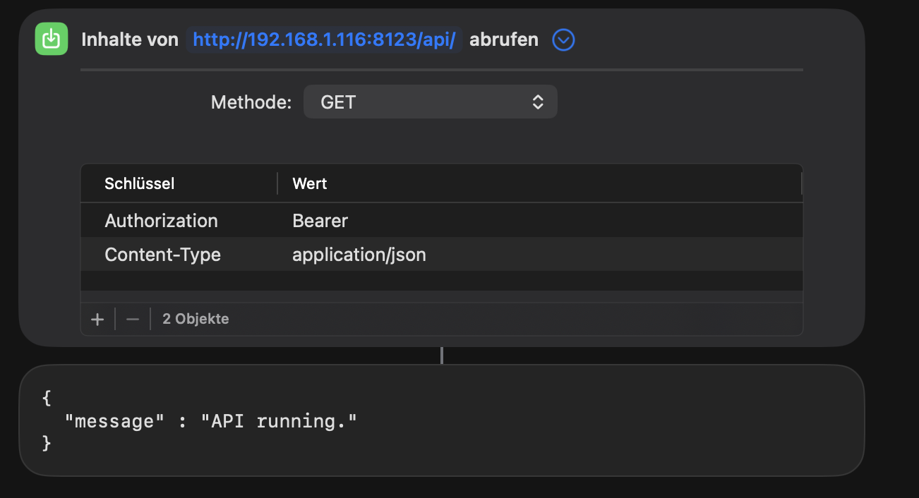

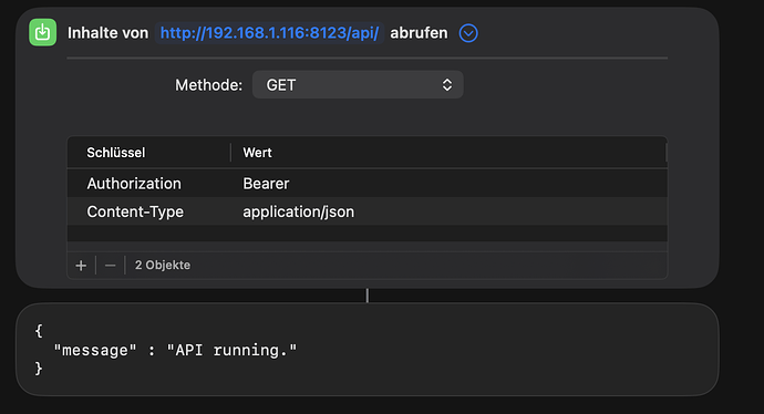

When I send a GET-request to 192.168.1.116:8123/api I get a response:
Would appreciate any help, I really dont understand why I get the 401-error.
Best,
Andrew
