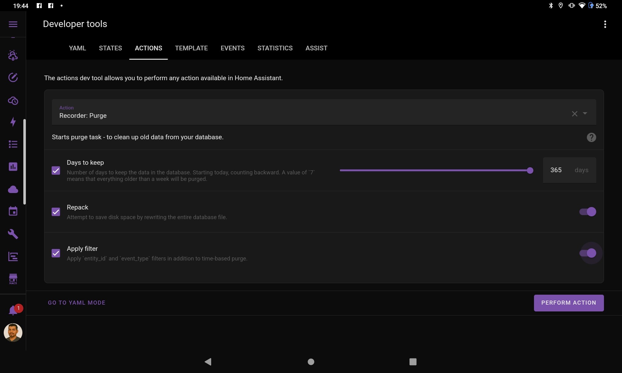

There is two Actions (Service Calls) to perform here.
Recorder: Purge entities
- Entities you want to completely remove from the database or history you want to delete.
- I always set keep days to 0 for these.
- I am not interested in their data or have completely removed the entity.
- Database size will not reduce until you have completed a
Recorder: Purgewith repack. - Select Perform Action and wait a good few minutes, there is no sign that the Action is complete.
Recorder: Purge
- I always set days to keep 365 (As I have rain data I want to keep for graphs)
- Select Repack True and toggled ON - must for database to shrink
- Select Apply filter and toggled ON - I have a long list of excluded entities in my recorder config.
- Select Perform Action and wait a good few minutes.
Having a graph that monitors the database size is a good way to see if the size has shrunk.
