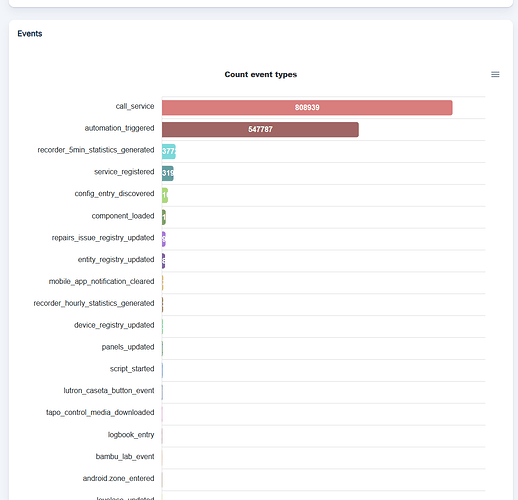

Now I need to figure out why I have so many call_service events being logged!
Call service happens everytime home assistant calls a service (action) in the newer versions. For me my node red automations I have alot of call service (action) nodes. I currently exclude all call_service events from my recorder database, with no negative affects.
One thing to note here is call_service calls may be many but they do not take up much drive volume in the database when compared states and state attributes.

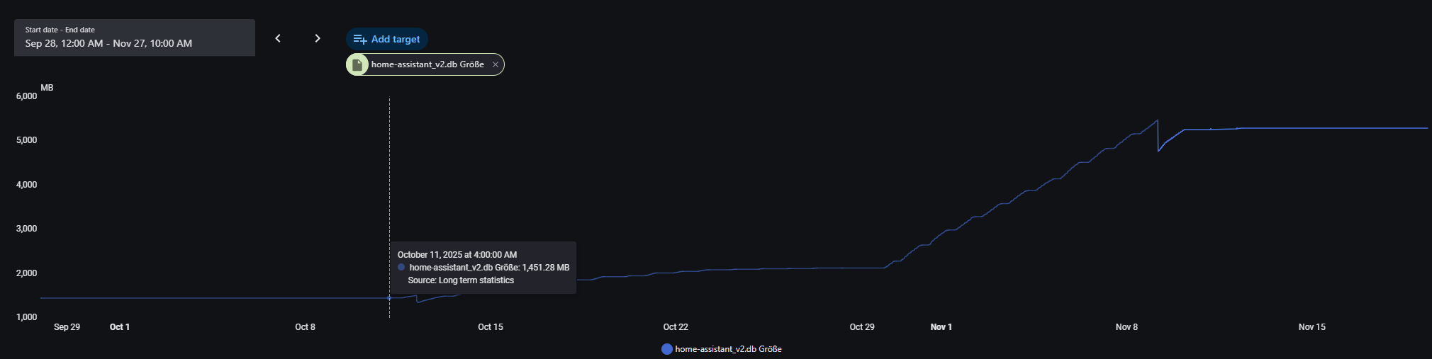

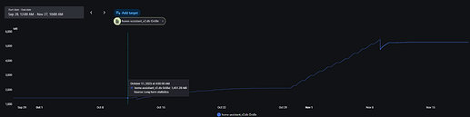

Hey,
i currently have a issue with my db size and i´m not sure from what this comming from. My HA instance is about 3 year old and i normally have a db size about 1GB but db size increased drastically and i´m not sure why…

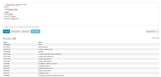

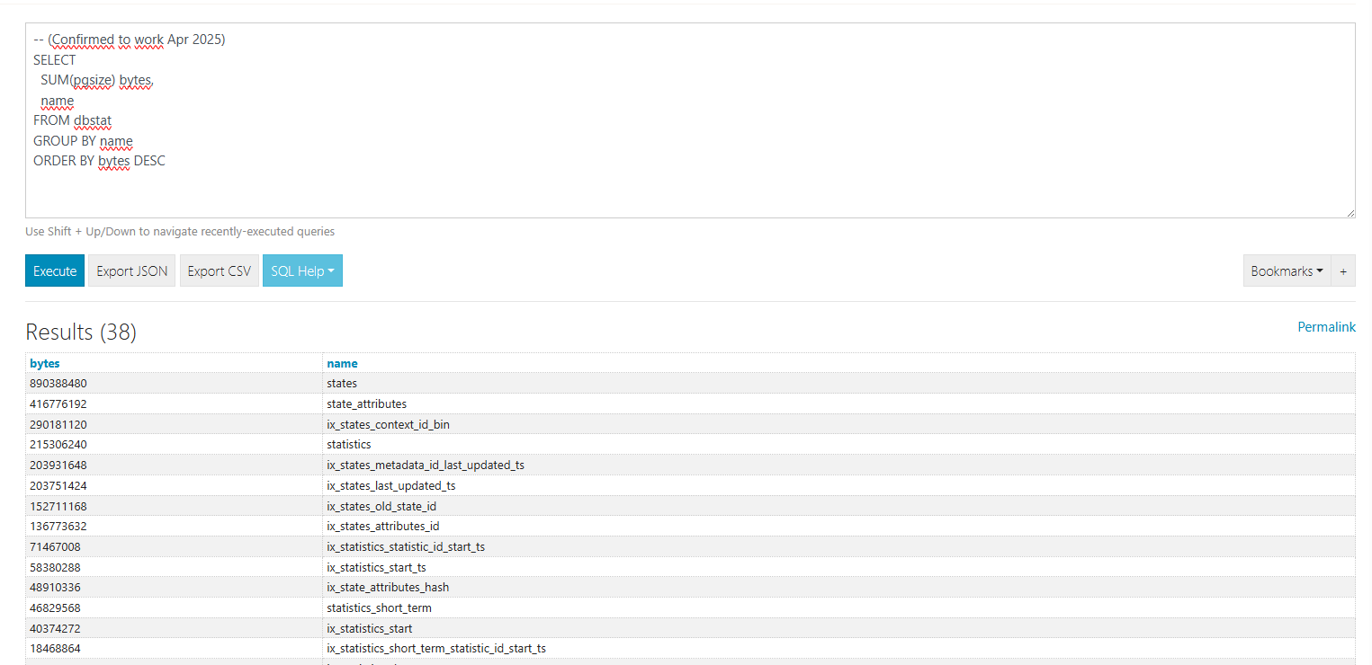

also if i check the via SQL i´m not sure why
recoreder settings are default.
anyone can help me to identify the issue?

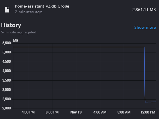

EDIT:
i executed a repack action and the db size looks better now:
did you already try to exclude entities from the recorder, or
limit the data storage period of some entities to a shorter period? this can be done with a automation which you can run for example weekly.
with the add on DbStats you can easily check which entities use a lot of space
