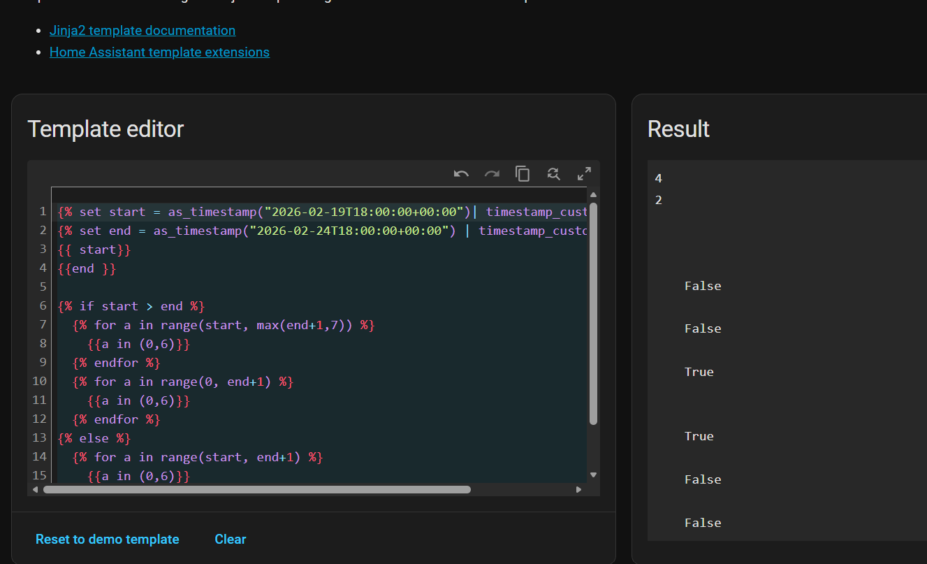

By no means a good way of doing it but this could be used.
Loop through the individual days of the event and if that day is 0 or 6 then its true.
{% set start = as_timestamp("2026-02-19T18:00:00+00:00")| timestamp_custom('%w') | int %}
{% set end = as_timestamp("2026-02-24T18:00:00+00:00") | timestamp_custom('%w') | int %}
{{ start}}
{{end }}
if it's past the weekend two loops is needed
{% if start > end %}
  {% for a in range(start, max(end+1,7)) %}
    {{a in (0,6)}}
  {% endfor %}
  {% for a in range(0, end+1) %}
    {{a in (0,6)}}
  {% endfor %}
{% else %}
  {% for a in range(start, end+1) %}
    {{a in (0,6)}}
  {% endfor %}
{% endif %}
