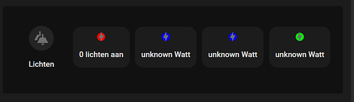

The issue
Everything worked out quite nicely, howevever I dont seem to be able to align the ‘subbuttons’ when using the custom:stack-in card. I have the feeling this needs to be done with advanced CSS using e.g. flex-grow in the right container but I don’t seem to be able to get there.
Below is as far as I got (basically using card-mod with fixed positioning as this overrides the 3 equal columns generated by the stack-in card. Obviously the moment the values change the mushroom cards will adjust their size and the margin between them will also change, which is what I want to avoid (dont mind the colors and icons etc, this is something I can work out). the issue is with the two ‘subbuttons’ on the right (or more if I want to add more).
work in progress card

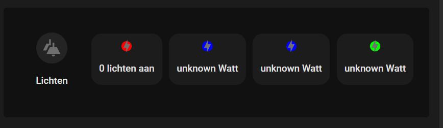

however, I do not know how to use a flex container with either custom-layout-card or stack-in card. I did come across some posts here on the forum using custom-mod-card, wrapping a horizontal layout card. however, when I try using that, I cannot for the life of me target the individual items in the container. Targeting the first ‘child’ targets all of the cards (see code below and a screenshot of the resulting card)

I feel like i’m stuck here, hoping someone can help out getting this flexbox with automargin implemented on any of the cards (custom-layout-card, custom-stack-in-card, custom-mod-card with horizontal stack, etc).
