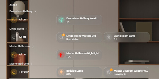

Sorry for the delay in responding, I've been offline for a couple of weeks. Thanks for all of the comments. Changing the visibility of the entity doesn't really do the trick here because I still want the indicator to appear in the dashboards, the fact that I can click on it to control it just as if it were a light is fine, and the fact that it looks like a light on the dashboard isn't really a problem either. It's the fact that they get grouped with lights and that they are controlled by "all".
The "weather orbs" being the example in this case (ignore the fact they are unavailable my zigbee interface is unplugged). As I design more custom dashboards I can put the indicators where I actually need them, so the fact that they appear on this automated lights dashboard is more an annoyance.. The biggest issue is that they should not be controlled by "all"... "all off" could result in a situation where a weather warning would not be seen, "all on" could result in confusion as it will illuminate in whatever color was last in use (so you might falsely believe their is a warning)... falsely think your garage door is open (or closed), etc.
