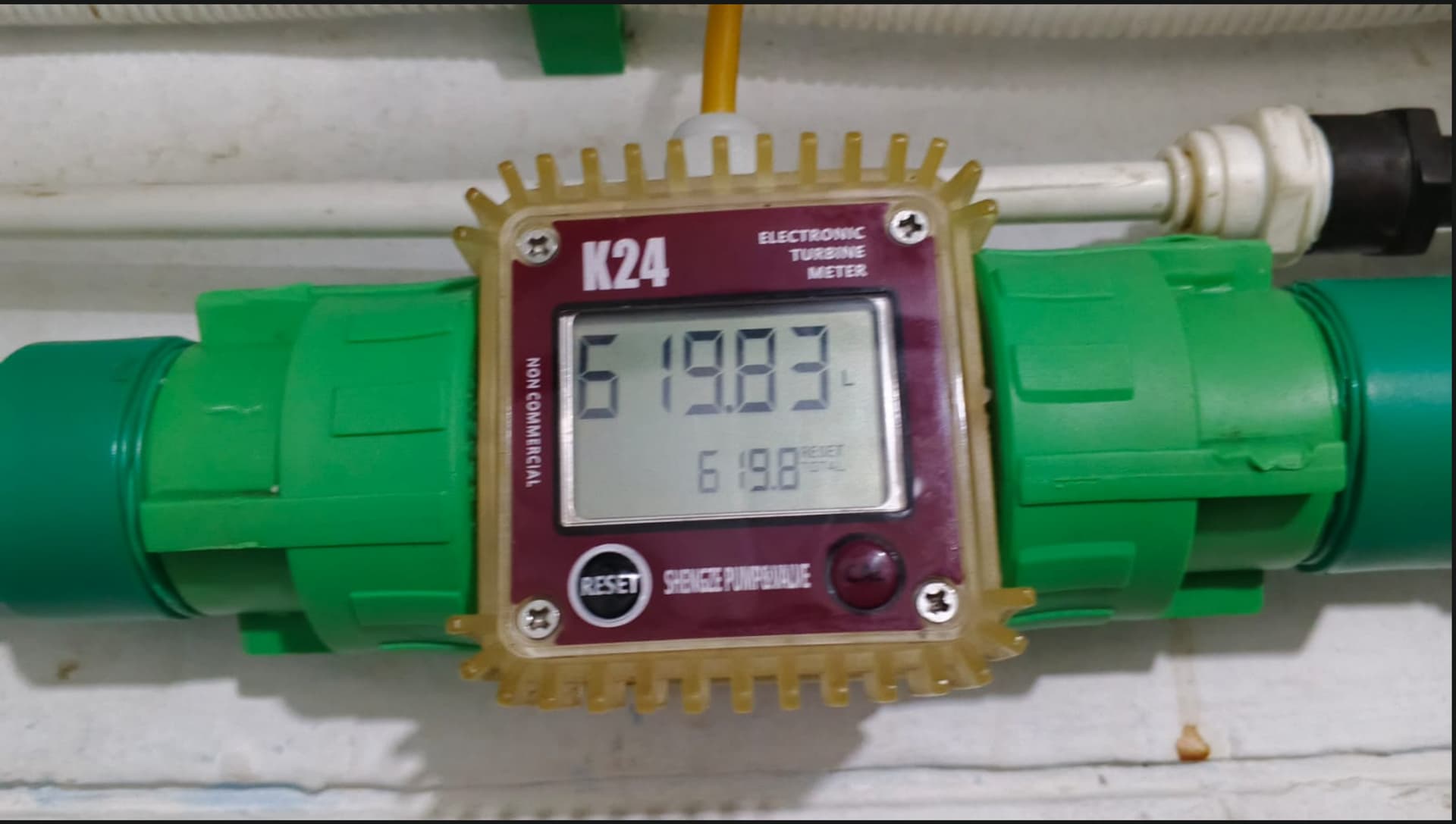

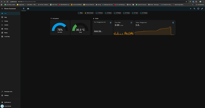

my problem is, i have digital water flow meter K24 that was i modification, using hall effect chip U18, that is working whell with measurement, but if my wifi network lost or power outage, measurement change to zero again, and i want ask how to make my total usage water, and measurement not affected when the device is unavailable (wifi network lost, or poweroutage).

  • sensor pulse hall effect (magnetic) read from turbine (K24 Digital Flow Meter)

Hei @donburch888 thank you so much for your replay, but i just find my answer from my friend, for make some template sensor that setting always available. btw thank you so much for your time
