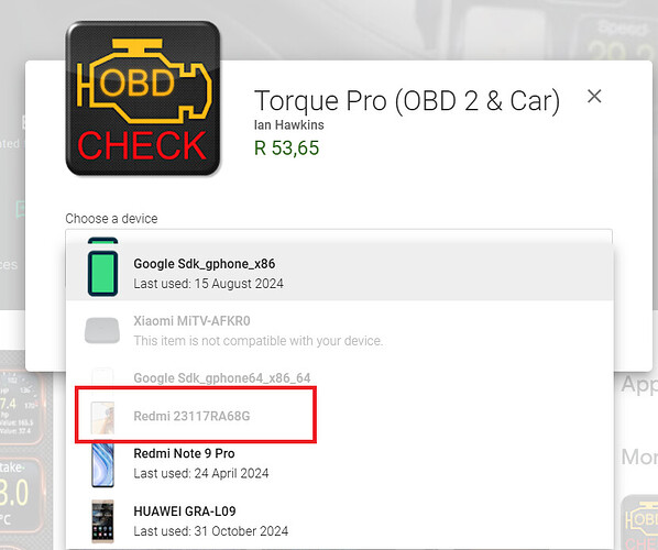

Strange - even Torque Pro is not available for my Android 14 device:

Torque has installed on my pixel 6, pixel 8 pro and pixel 9 pro xl and now running on android 15. I don’t think it’s the version of android. Maybe your phone?
