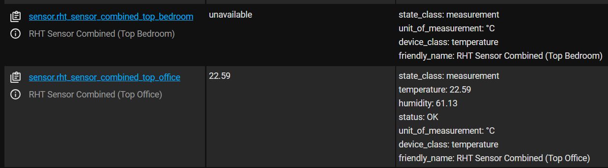

The problem is that when the sensor dies, the values of the source sensors change to “unavailable”, and therefore so does the combined sensor. This is fine, but when this happens, the attributes of the combined sensor are simply missing. See this screenshot, which shows the result for a working sensor and a broken sensor:
I would like the attributes to still be present (and show something like NaN, NaN, and DOWN for the humidity, temperature, and status).

There’s no way to do what you want. It’s simply just not possible with how the code currently works for the template integration.

You would need to remove your availability template so that the sensor never goes unavailable. You could instead make your state template resolve to none when the source entities are unavailable, and in that case the state would show as unknown but the attributes would still be there.
As Petro made clear, there is no way to have attributes when the sensor is unavailable.
