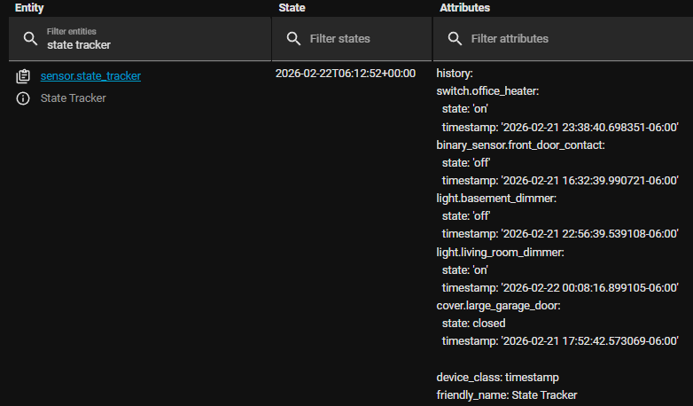

Ok, so there is technically a way you can do this with only creating one single helper, and you can use that same helper for every bulb and for anything else you want to have a persistent “last changed” recorded for. But it’s going to require templates. Lots of templates.
As a bit of a challenge and because I was interested myself, I created a single template sensor that can record the “last changed” timestamp of any entity that you apply a label of “State Tracker” to. Here is what that template sensor is. Since this is a trigger-based template sensor, you have to place this in your configuration.yaml, or your templates.yaml or however you have your config split up:

What you end up with is a single sensor that has a history of the last time any labeled entity changed, and it ignores unavailable and unknown states and won’t update the timestamp if the same state happens again later. So restarting HA doesn’t affect the history. Here’s what it shows:
This works out really nice, and it is pretty easy to manage since you just have to label things. After adding or removing a label on an entity, you have to either restart, fire the custom event (state_tracker_refresh), or change the state of an already-tracked entity.
