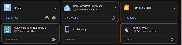

Yesterday, something went wrong with my HAOS. The supervisor doesnt seem to be working. I’ll attach a few screenshots below:
It keeps trying to spawn run and fails…
The supervisor is not working, so other stuff like ssh and terminal are also not working…
There are definitely backups as I automated them, but they seem to be not visible from the web UI.
