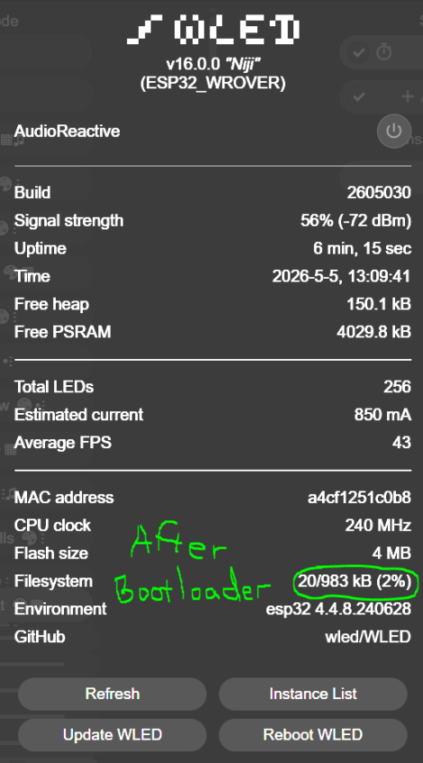

I’m somewhat familiar with flashing ESP32 and ESP8266 devices and just today after playing around with an ESP32 WROVER with both an ESPHome build and then a WLED build, I discovered that WLED really wants you to re-write the bootloader to free up space for the filesystem:
These pictures are from the same device with just a flash of the bootloader file found in the v0.13.1 github release as recommended from this page: Install WLED Binary - WLED Project
