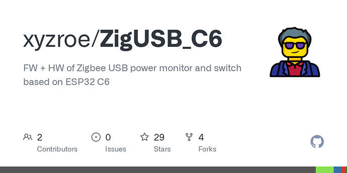

It’s feasible, but you’ll probably have to make your own since the linked shops always show out of stock. No idea if it’ll work with USB-C though - I don’t own one & simply know about it because I saw it in the Z2M supported devices section.

Thanks for sharing, I wasn’t aware of this specific product.
I do already have Tuya zigbee USB power meter (bought on AliX, of course), but I’ve seen them only come in USB-A version, and additionaly, they only work with 5-12V. So I was hopeful that there’s a similar product out there, but for USB-C.
