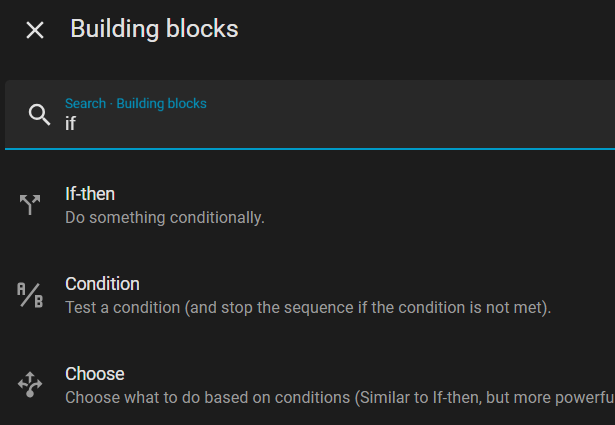

Instead of adding actions (to run the dinner2tv script, for example), you can add building blocks:
… and then, maybe use one of those to check whether conditions are or are not met, before proceed to your dinner2tv script.
The trick is probably going to figure out some other conditions to check, to decide whether the automation would proceed or ignore the action…

And let’s add building block If-then instead of adding any action.
Under the “if” of the forementioned If-then block, you do another logic block And to check both of these being true:
… assuming you have figured out the logic for c)
and then, under the “then” of the forementioned if-then logic block, you include your action.
