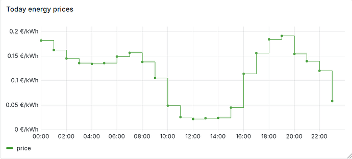

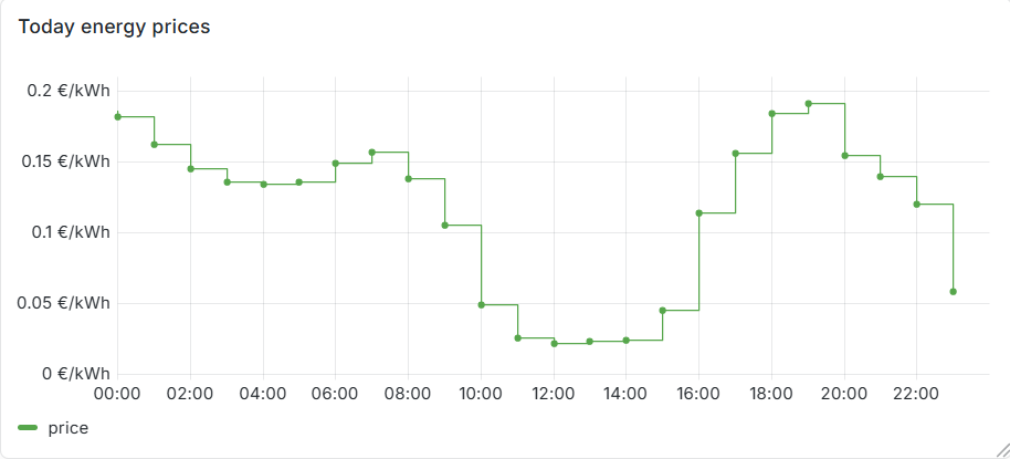

Flux query to do it:
import "array"
import "strings"
import "regexp"
import "date"
pad2 = (s) => if strings.strlen(v: s) == 1 then "0" + s else s
fromToRFC3339 = (entry) => {
    fromPart = regexp.findString(r: /'from': datetime\.datetime\([^)]+\)/, v: entry)
    cleaned = strings.replaceAll(
        v: strings.replaceAll(
            v: fromPart,
            t: "'from': datetime.datetime(",
            u: "",
        t: ", tzinfo=tzutc())",
        u: "",
    parts = strings.split(v: cleaned, t: ", ")
    return
        parts[0] + "-" +
        pad2(s: parts[1]) + "-" +
        pad2(s: parts[2]) + "T" +
        pad2(s: parts[3]) + ":" +
        pad2(s: parts[4]) + ":00Z"
entryToPrice = (entry) => {
    pricePart = regexp.findString(r: /'price': [0-9.]+/, v: entry)
    return float(v: strings.replaceAll(v: pricePart, t: "'price': ", u: ""))
raw =
    from(bucket: "home_assistant/autogen")
        |> range(start: today(), stop: date.add(d: 1d, to: today()))
        |> filter(fn: (r) =>
            r._measurement == "€/kWh" and
            r.entity_id == "current_electricity_market_price" and
            r._field == "prices_str"
        |> first()
rawValues = raw |> findColumn(fn: (key) => true, column: "_value")
pricesStr = rawValues[0]
body = strings.replaceAll(
    v: strings.replaceAll(v: pricesStr, t: "[", u: ""),
    t: "]",
    u: "",
entries = strings.split(v: body, t: "}, {")
rows = array.map(
    arr: entries,
    fn: (x) => ({
        _time: time(v: fromToRFC3339(entry: x)),
        _value: entryToPrice(entry: x),
array.from(rows: rows)
    |> rename(columns: {_value: "price"})
    |> keep(columns: ["_time", "price"])
