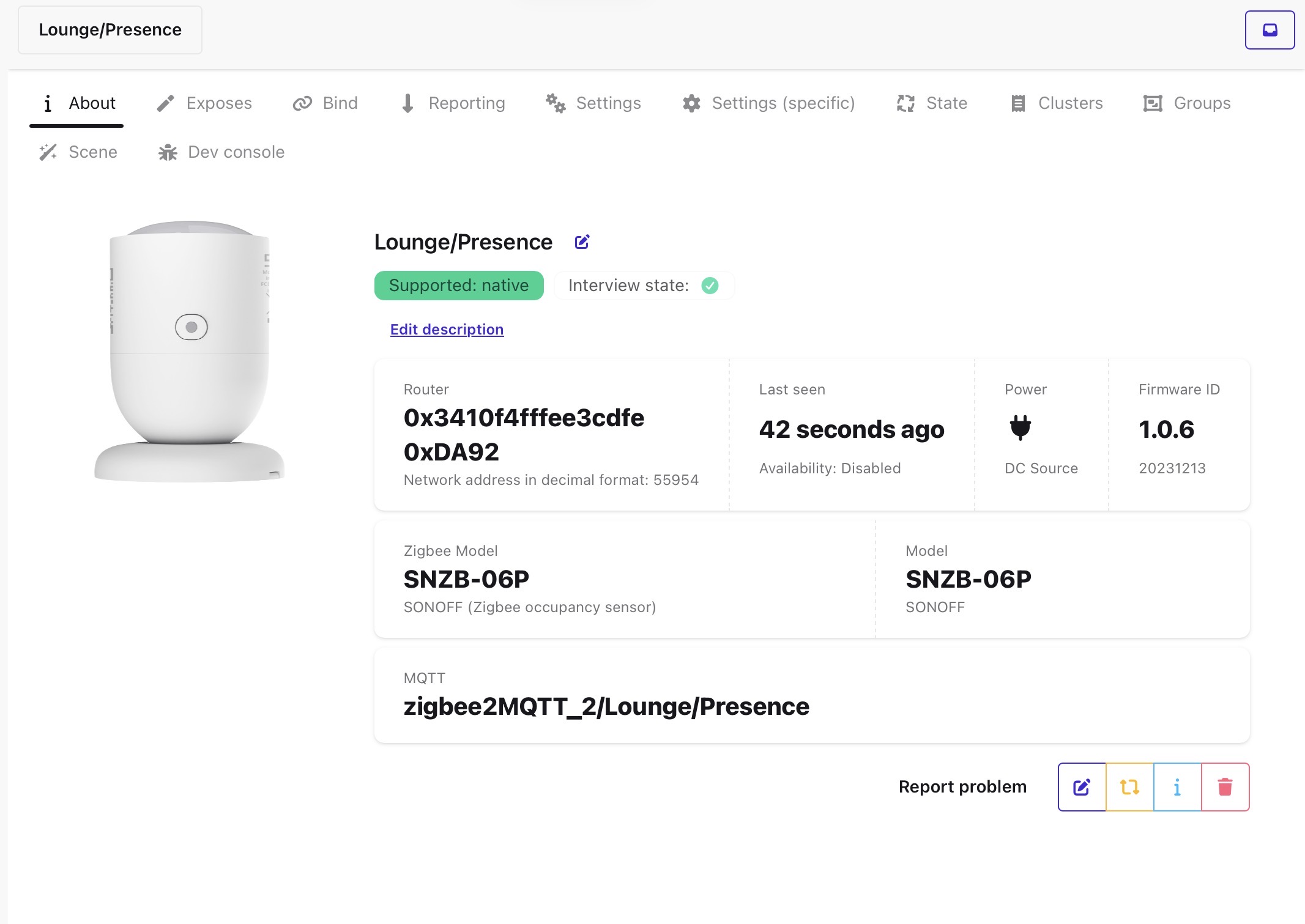

I am using several sonoff presence detectors and most of the time they work great.
But sometimes just fails to detect presence.
When this occurs unplugging and plugging it back in again fixes it.
But so does pressing the refresh button in zigbee2MQTT see photo and circle :o:
Can anyone tell me how to press this button using an Home Assistant automation or node Red option?
Much appreciated

Nah a get doesn’t do it.
but pressing the refresh button does, anyone know how to replicate that in a Home Assistant automation or mqqt action?
I think I have it.
Perform a xxxx/get with a payload of ‘occupancy’
That is is what the zigbee2MQTT interface seems to be sending
