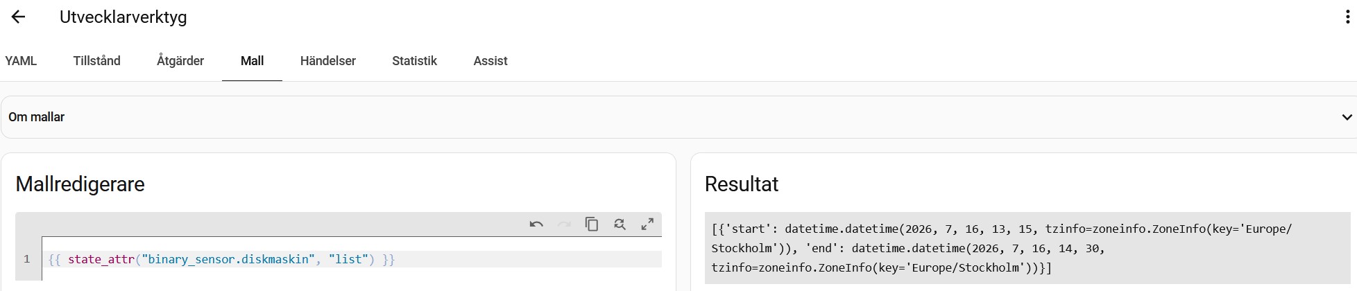

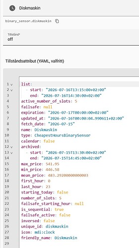

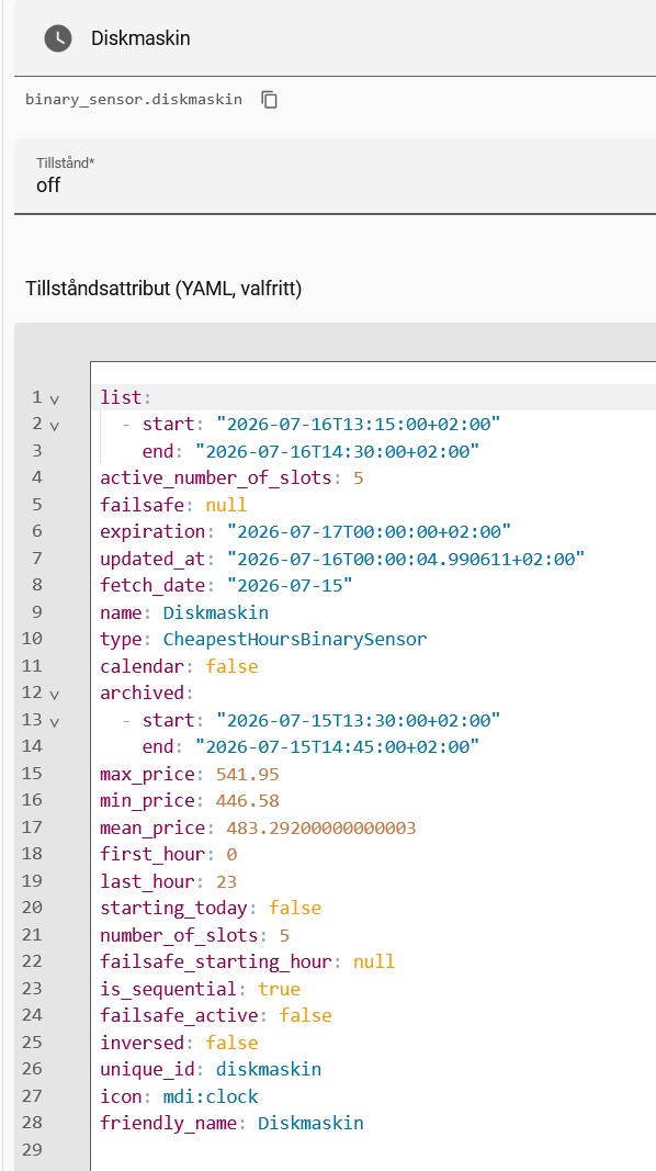

So I have AOI Energy Management installed, and I have defined a entity I guess that gives me the best hour to run my dishwasher. The returning entity has a list with start and end times. Now for this one I only get one (start/end time) since that is how it is defined, however the solution could give more than one IF that is how one defines the settings. But as I wrote, it is setup for one and one start/end time only. And it returns a list, and I have no clue how to get hold of that start time to present in lovelace. Any idea?

{{ State_attr('binary_sensor.dismaskin', 'list')[0].start }}
Automatic capitalization unfortunately messed up hellis’s otherwise fine template. the capital S should be a lowercase s.

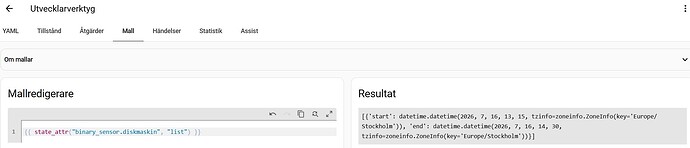

{{ state_attr('binary_sensor.dismaskin', 'list')[0].start }}
Just for clarification: The “diskmaskin” word is incorrect spelled in the code - and that is kind of on me since I used a screen dump instead of the code as was pointed out. So the code did not work until I replaced it with the correct spelling. Again, this is maybe on me :slight_smile:
