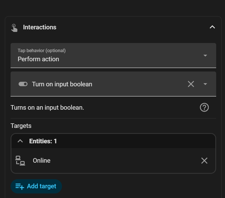

Otherwise, just do everything in the UI under the Interactions part of the card - that will definitely generate the correct output:

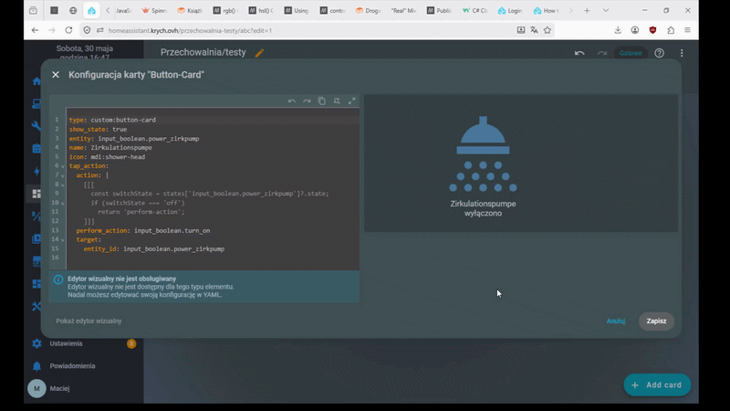

record_2026-05-30_16-48-23-ezgif.com-video-to-gif-converter
I mean, when pressing the button, nothing happens, nor color changes. Checking the state of the entity says for input_boolean.power_zirkpump "off", although I have pressed the button.

You have an apostrophe at the end. After removing it, the card works for me! After clicking it, it changes color from blue to red (and becomes non-clickable). P.s. you can check you button-card version in HACS. Don't update, just check.
