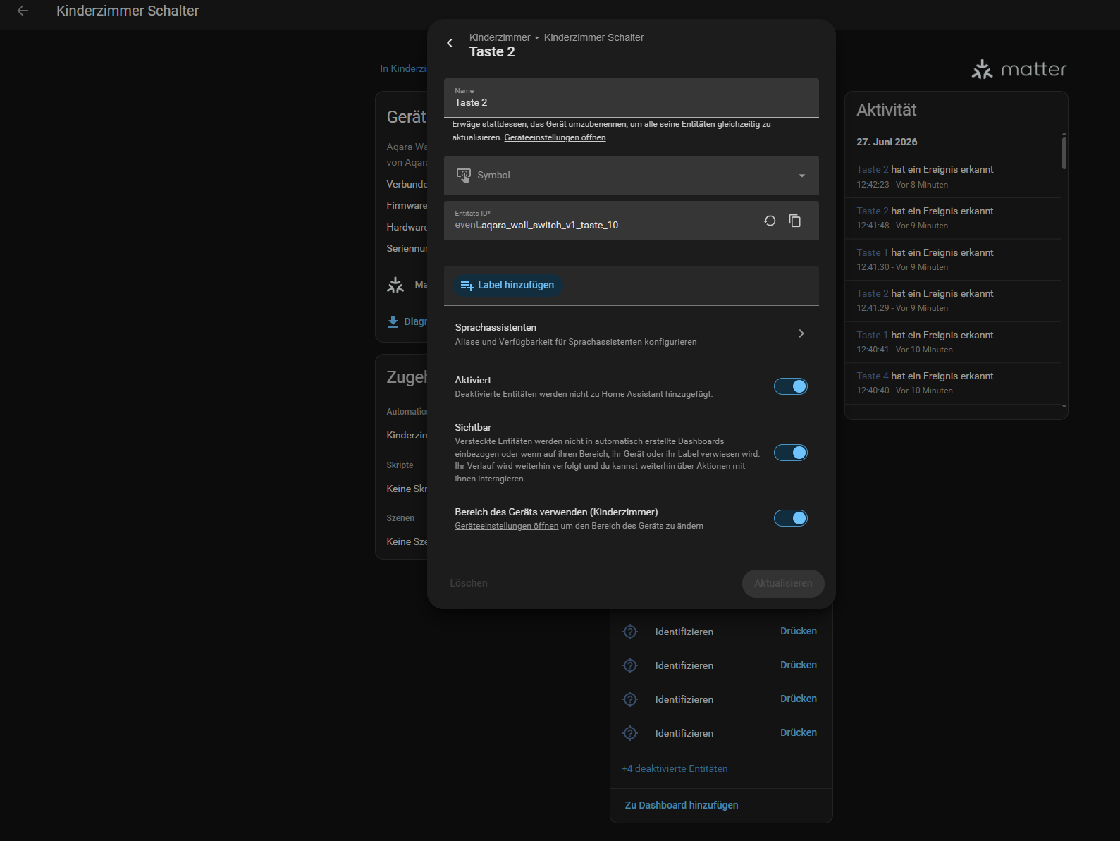

Hi everyone,
I recently added some Aqara Wall Switch V1 switches to my Home Assistant setup. They are connected locally via the Aqara Hub M3 using Matter.
The devices show up fine, and I can see the button presses perfectly inside the Home Assistant logbook / device activity history (it registers the clicks immediately).
However, I am struggling to find the "best practice" way to use these button presses as a trigger for my automations. Since it is an event entity via Matter, it doesn't have a simple on/off state.
What is the most simple, reliable, and native way to set up a trigger for "Button 2 pressed" in the visual automation editor? Should I use a state trigger, an event trigger, or something else?
Any help or a quick example (UI prefered) would be greatly appreciated!
Thanks in advance!

That makes total sense, and I completely agree with you. I honestly expected that a simple wall switch triggering a basic automation would be something I could easily click together entirely within the GUI.
It feels a bit counterintuitive that such a standard real-world task immediately requires diving into YAML or tracking down specific attributes like newPosition just because the device uses Matter under the hood.
I understand why the community prefers sharing YAML here since it avoids all those UI translation quirks, but it’s definitely a bit of a hurdle when you just want to set up a quick, native automation using the visual editor!
