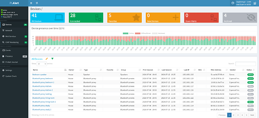

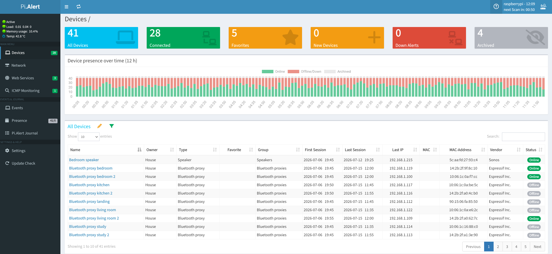

An alternative approach - although a project in itself - is to use something like Pi.Alert to track our devices via MAC address.
There is no specific HA integration for this particular application, but there is a web UI which you can show in a dashboard.
There is an optional API, so you can import data about specific devices. There’s a post about it here.
Pi.Alert has it’s own notification system, so you may not need to go through HA.

Also @robertsaron that screen looks an awful like the NetAlertX app which is in HA and will do the trick for you. An integration for your router brand would be easier though if it existed.

Correct. NetAlertX is a fork of Pi.Alert - and there are several versions of that.
