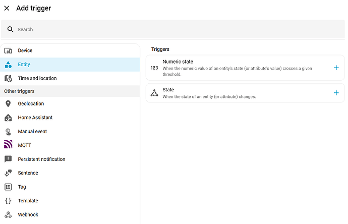

I also tried the GUI automation, but in the trigger options there is not possible to send a value like every second. There is only option “When the numeric value crosses a given threshold”, which is of course not what I want. Or I have to select other ways for automation?

You can select the interval one bullet below in “Time and location”.
Thanks, it is working!
