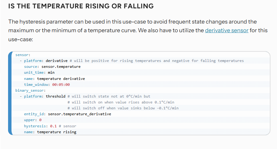

I may have misunderstood the example given in the Threshold documentation ( Threshold - Home Assistant) but it looks as though using the Derivative sensor (https://www.home-assistant.io/integrations/derivative/) in combination will give you what you need:
