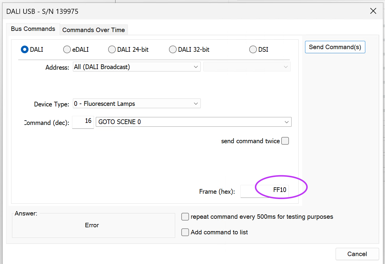

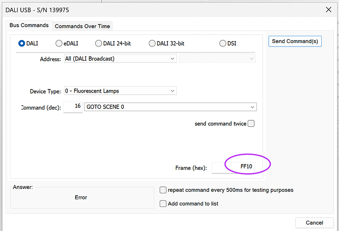

  2. DALI Command “GOTO SCENE 0” is 16 in decimal, so 10 in hex. Meaning the full command to activate for example Scene 0 is FF10.
See below for the configuration of the REST command and HA example. Works?
