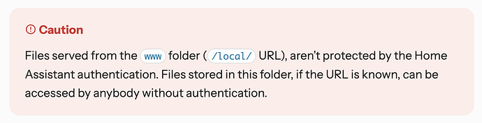

No, it is not possible and if such a thing were possible it would be a serious security issue. Files under the www folder (/local/) are public and they don’t need any kind of authentication. If you allow to access any file in your system using a URL path, that would allow anyone to query your config file or your secrets just querying them from the URL.

I am seeing that you want to access that folder from a front-end custom plugin. Unfortunately, the aforementioned option is to make the folder available to any integration or script that wants to access it to store files, but it will not make those files available through the URL for the reason that I explained before. If you want to provide files for being available by front-end plugin you must put those files inside the www folder, there is no alternative solution for that.

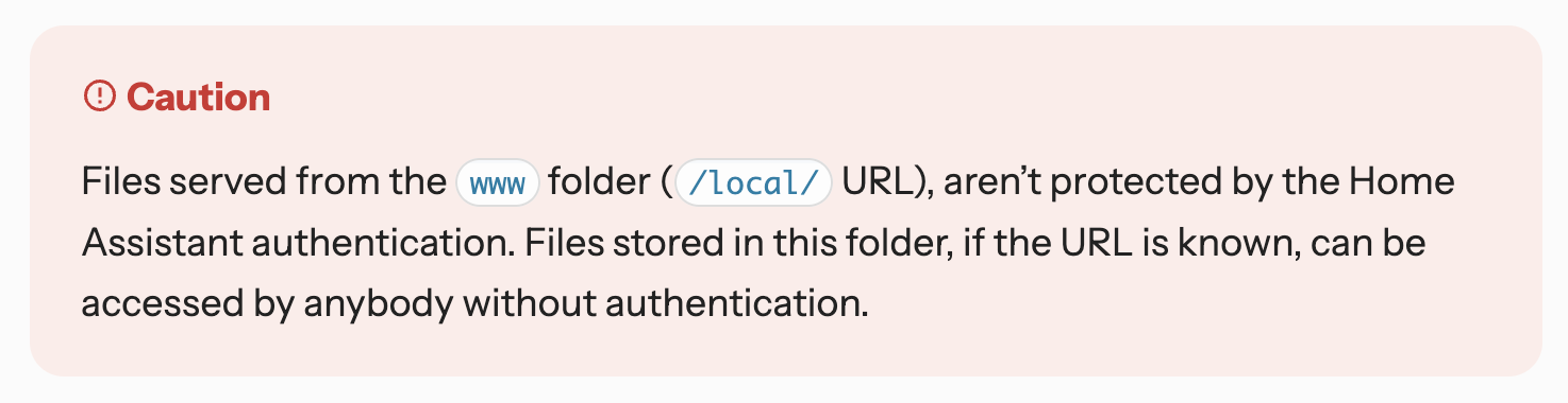

Yes, I think that there is a little misunderstanding here. :slightly_smiling_face:
The code of the configuration file (or a dashboard in yaml mode) is processed by the Home Assistant back-end and it is possible to split it
lovelace: !include lovelace.yaml
In that case it does not need to be located in the www folder.
Do not confuse that process with trying that a custom front-end plugin loads a file, in those cases the file must be inside the www folder because a front-end code cannot access a file inside the config folder through a URL path.
the link is well known.
