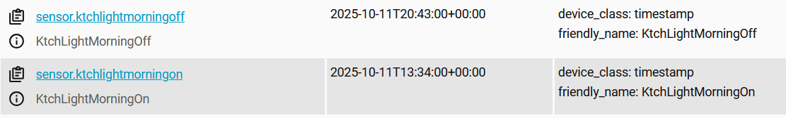

One last question, when I add in that code, it works but it adds about 7 hours between the on and the off sensors (the random minutes looks good, staying within the up to 21 minute difference).
Any thoughts on why it says 20: when the on says 13:?
First, make sure you are using the correct entity IDs… what is shown in your screenshot is not what you provided us in the original post.
Second, any time things are offset by whole hours, timezones should be double checked. Is your HA instance properly set to your local timezone?

Thanks, I’ll muddle my way through this remaining issue. The sensor.ktchlightmorningon is needed versus sensor.ktch_light_morning_on as that doesn’t return a value. Anyway, I will look for where the extra 7 hours is coming in.
