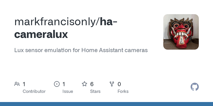

This ?
Lux sensor emulation for Home Assistant cameras

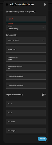

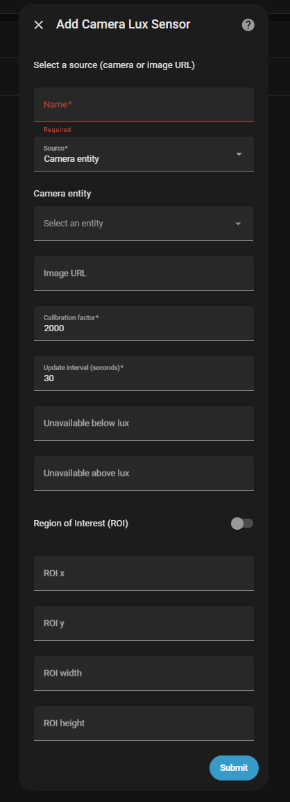

In case anyone stumbles across this thread and needs a solution.
Settings - Devices - Add Device - Camera Lux
It should bring up a menu to add everything in.
Look in the Entities menu for whatever you have just created.
Hope this helps
