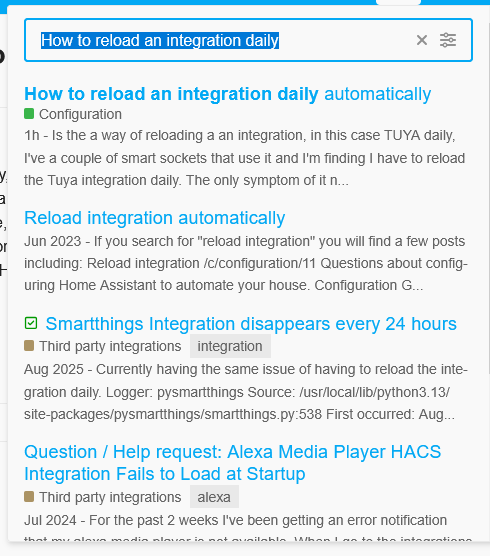

You might find some clues in this search
