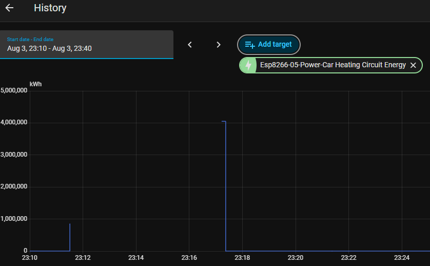

How to remove a rogue 4 Gigawatt consumption spike from hot water pump?
I again find my stats ruined by a massive spike in consumption from my heating ciruclation pump.
For whatever reason, spurious data has destroyed my stats with no way to clean it up, this time emenated from my PZEM-004T
Yes i can edit the state stored to clear this entry up, but is there any method on the roadmap to clean up the Long Term Stats that are ruined for, well, a very Long Time!
Nice and shiny new features get rolled out and the product improved, but are there plans to help correct these bursts other than to roll back my database?
Is there no way we can clear up short term stats and then re-run the Long Term Stats creation???
