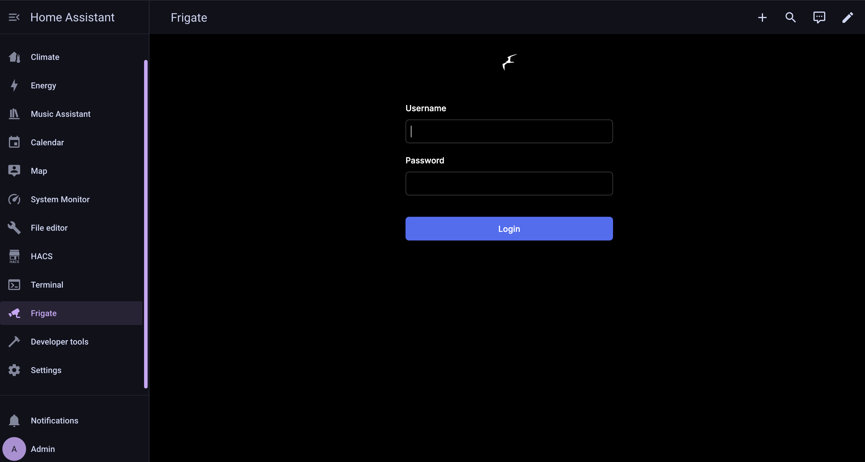

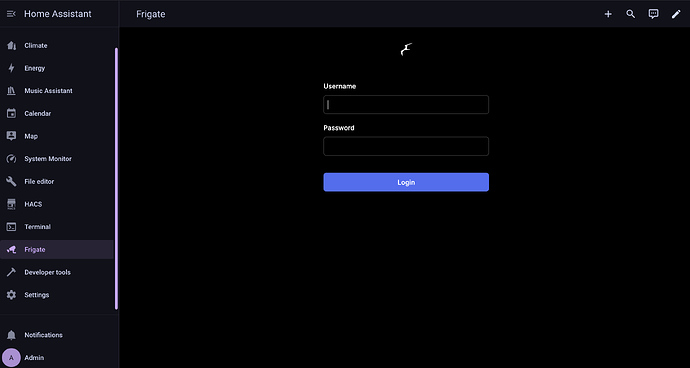

I had this same issue and figured out an alternative this morning that seems to work well, with the added benefit of allowing RBAC in Frigate itself so not everything has access to admin.
  1. Go to the Frigate Add-on Configuration tab, go to Network, select ‘Show disabled ports’ and add 8971 to the Authenticated Web Interface. Restart Frigate
  2. Check this now works in the browser by accessing the exposed port (something similar to https://192.168.50.X:8971). You should get the Frigate login screen
  3. Create a new dashboard in Home Assistant using the Webpage template. Select ‘Show in sidebar’ and ‘Admin only’. When prompted for the URL, use the one you tested before
You will now have an admin only access to Frigate with additional RBAC. If you wanted to skip the login screen you could expose the unauthenticated port instead but this seemed like a bad idea…
