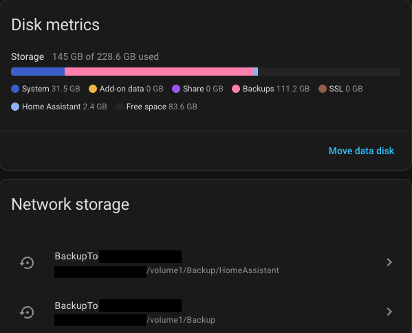

I have created backup schedules to write to my 2 synology NAS servers. All is going well here. But…I have noticed that on my HA SSD there are still many older backups that I would like to remove to free up space. I have not been able to find this from within HA so I’m a bit puzzled here. What direction do I need to look?

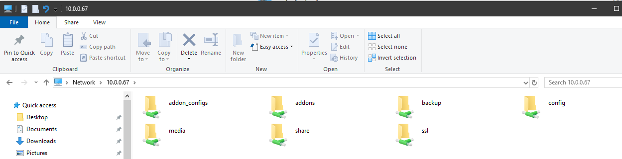

  2. If you have SMB access enabled on your HA Host go to \\Your.IP.Address\backup and delete from there

if you installed the samba add-on, backup should be visible

Thanks for the tip. I didn’t have Samba implemented. Having done so I could see that in the backup folder there were old backups from 2024 still present. Strange enough I could not see them in the backup overview itself. However, with Samba I could look into the folder itself. I have deleted all of them and the backup is now only 3.5Gb.
