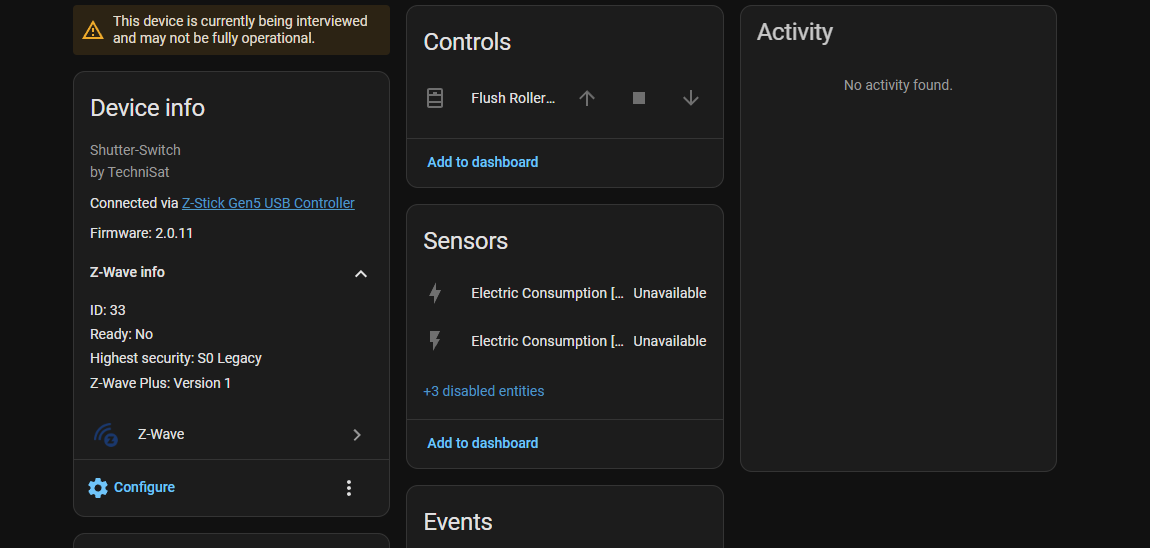

How to replace a zwave device but also keed the same Node number
In ioBroker it was possible to use a “replace” function if a device was bugged and needed to be reset, or if a device was defective and had to be replaced with a new one (but the same model).
How can I do that with Home Assistant? I would like to keep my node number so I don’t have to change my automations.
My device is no longer responding. I would like to try a reset and re-include it, and if that doesn’t work, replace it with a new one.
If I understood correctly, this should be possible with “Z-Wave JS UI”. However, I installed the official “Z-Wave JS” add-on. Is there a reason why there are two different versions?

Ok now i rited and “replace” function works with ZwavejsUI
