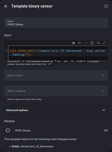

FWIW, that should really be a binary sensor, not a sensor. Then your state template would just be a boolean expression:
{{ is_state_attr('climate.lyric_t5_thermostat', 'hvac_action', 'heating') }}

Only fields mark with an * are mandatory. For Template sensors and binary sensors that’s Name and State
Thanks!
In updating my old yaml to new yaml, I didn’t realize that I should now be using template binary_sensor instead of sensor, which resulted in a bunch more irrelevant mandatory Helper UI fields. Makes sense.
