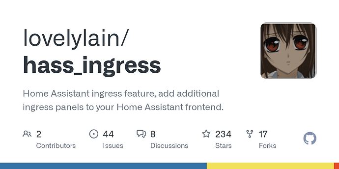

There is a custom integration that performs this feature for container installations:

I have always exposed my HA to the internet, with HA docker, I had to separately expose my add-ons each to the internet and utilize their own authentication mechanism, just troublesome.
hass_ingress allows me to hide everything behind HA docker’s authentication.
