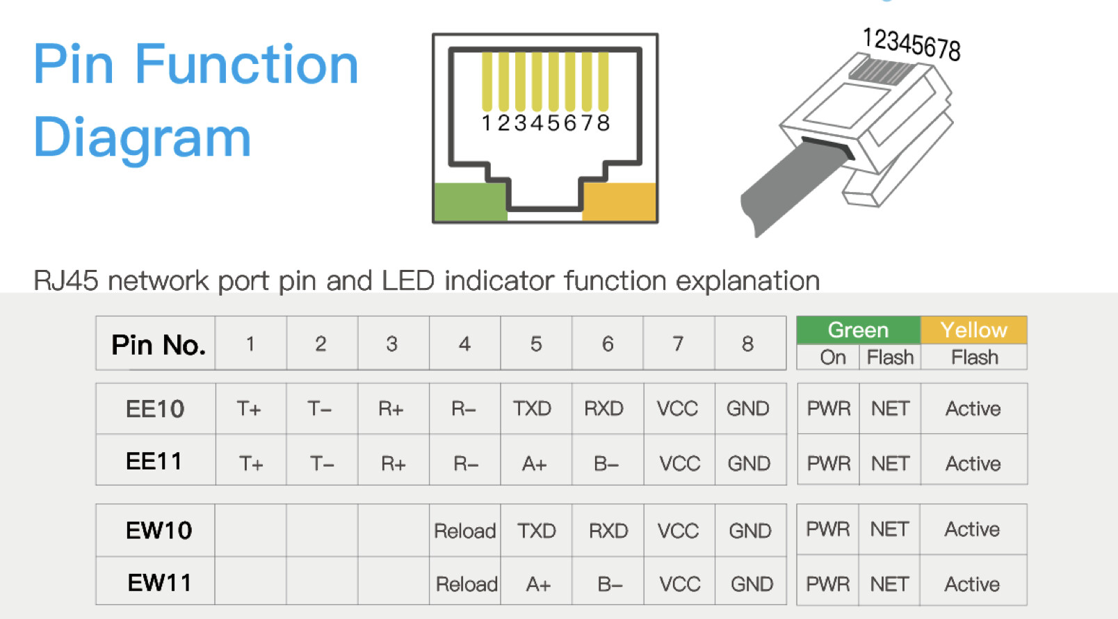

For the EW11A, the manual says to “connect reload pin to GND” for reload (<1.4s) and factory reset (>4s). But the EE11A, doesn’t seem to have a reload PIN:
Has someone managed to reset/reload a EE11? Is there another way to re-configure the converter?
