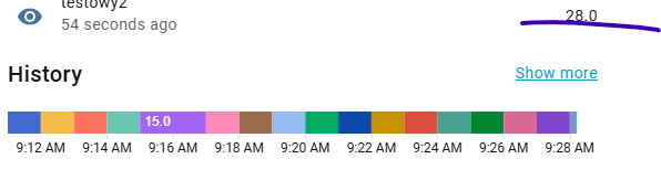

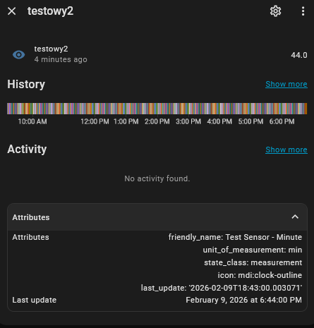

But it looks like the value is ‘stirng’ not number, and when i want to plot that i see
insted of plot.
How to fix that?
The state of a sensor is always a string. There is no way to “fix” that: it is by design.
The plot is shown that way because your sensor does not have a unit of measurement. I see that you’ve tried to set one, but for some reason it hasn’t worked.
EDIT: got it. state.set() doesn’t have an attributes argument. It’s new_attributes:
https://hacs-pyscript.readthedocs.io/en/stable/reference.html#state-variable-functions
That’s also why your graph is headed “testowy2” with an “eye” icon: the friendly_name and the icon are also not set for the same reason.

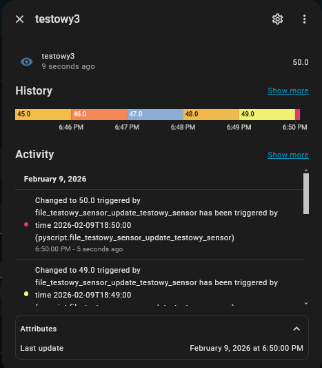

Hey
So my sensor.testowy2 has proper attributes
it has even unit of measurement, but still doesnt work.

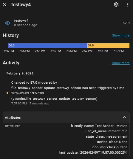

and it is worse i d say, because I have (no attributes like unit_of_measurement, state_class itp)
you’re missing device_class. You need all 3 for it to be a numeric result. state_class, device_class, and unit_of_measurement.

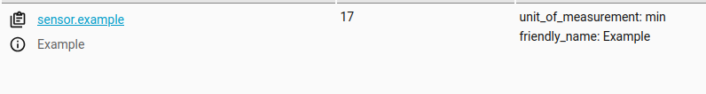

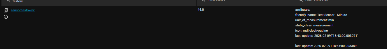

You’re doing something wrong here: your attributes for testowy2 and testowy4 are under a dictionary key called attributes.
Compare your screenshot of the states page above with mine:
See the “attributes:” at the top of your right-most column? Shouldn’t be there.

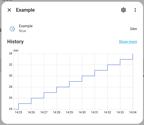

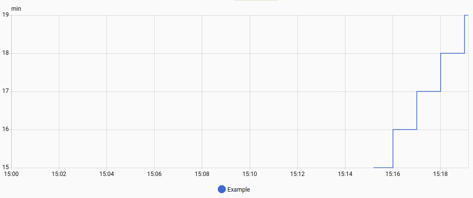

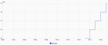

If you want the sensor’s graph to appear as a line chart, instead of a bar chart, the sensor must have device_class and unit_of_measurement options with appropriate values.
template:
- sensor:
  - name: Example
    state: "{{ now().minute }}"
    device_class: duration
    unit_of_measurement: min
To be clear, the sensor’s state value is still a string (as is the case for all entities). It is the presence of the two options, with appropriate values, that influences the UI to display the sensor’s values with a line chart instead of a bar chart.

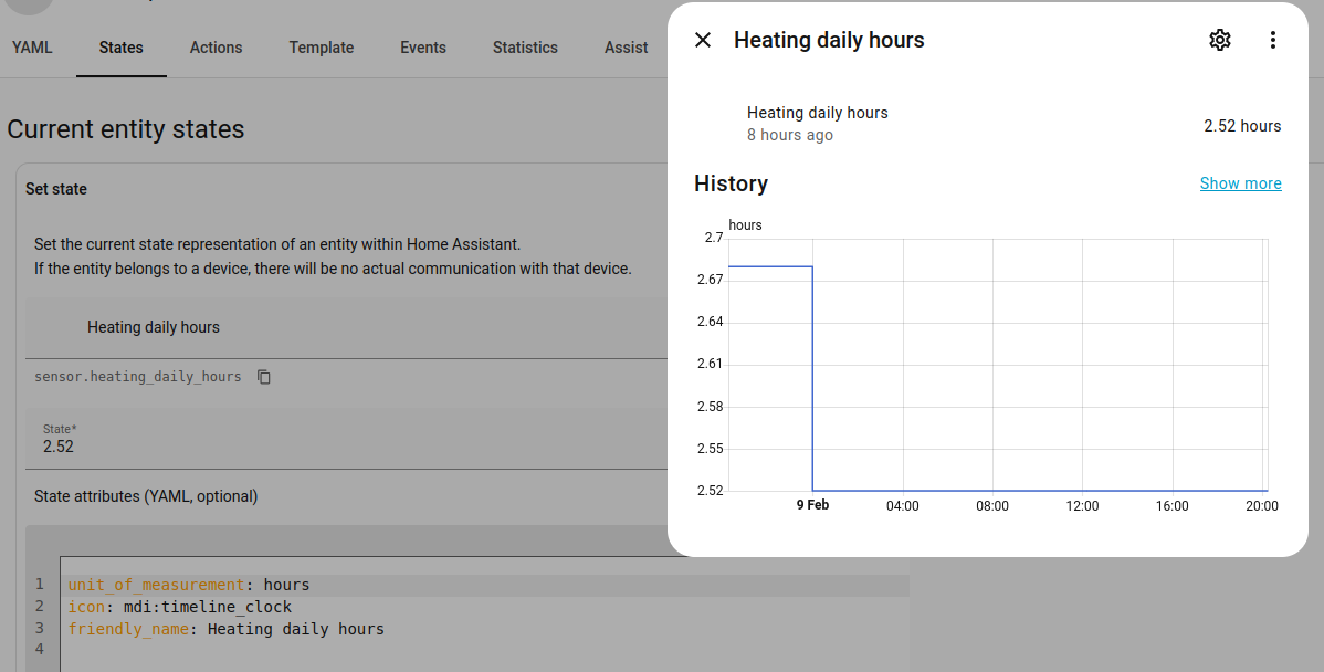

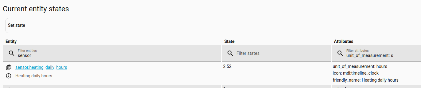

@123 @petro — whilst it might be good practice to set device_class and state_class, I have plenty of sensors with neither (unless they’re implicit and hidden), just a unit_of_measurement, that show up as a graph:
I agree. The bare minimum is that one option to influence the UI to use a line chart.
