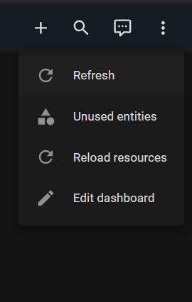

  1. that is not that hard.
    All the dashboards have a 3-dot menu in the upper right corner.
    The refresh option will reload it.
