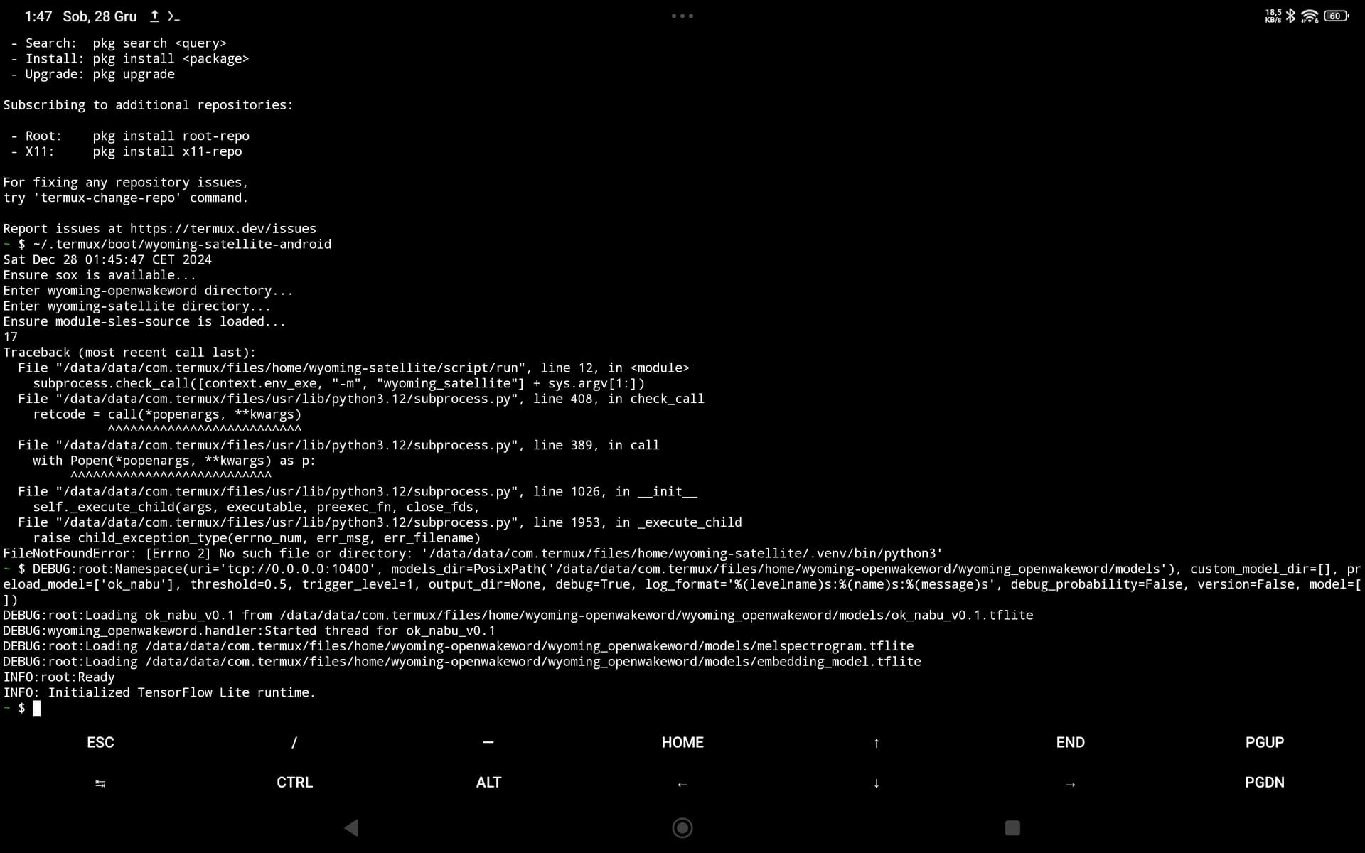

I tryed many install script, manualy install everything but all time i get that error:
I dont have any more idea … in that folder python3 don’t exist
I had the same problem.
I needed “su” on a rooted phone.

If it can’t find python in that directory then something went wrong during the installation where the venv is generated. Maybe try reinstalling.
As i mentioned i tryed many install scripts (your even 7 times) everytime same issue. I reinstalled it like 20 or 25 times already with no result
