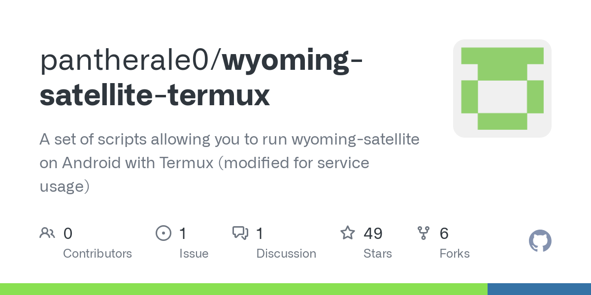

https://github.com/jeffc/hassmic
I’ve tested it and it works great

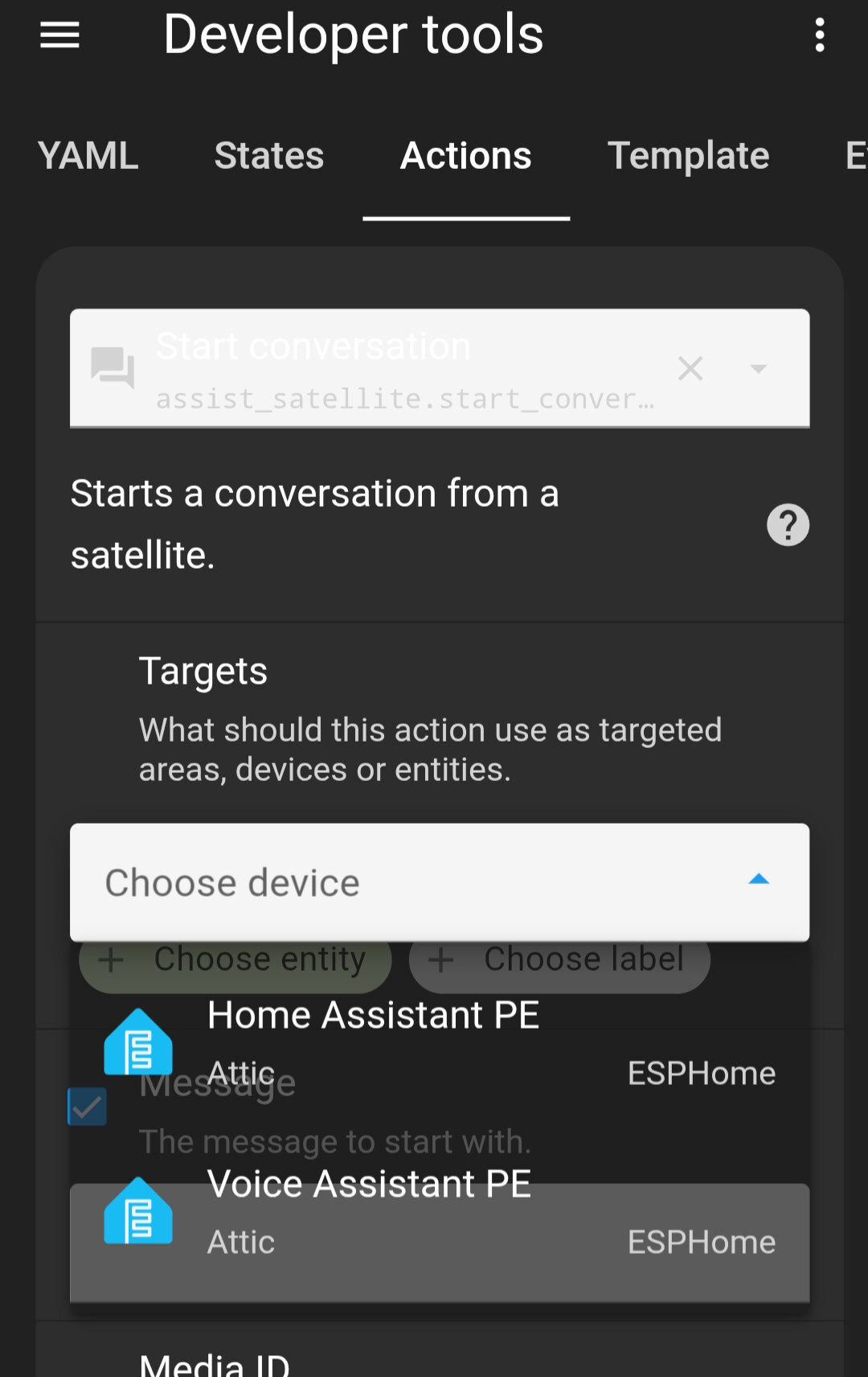

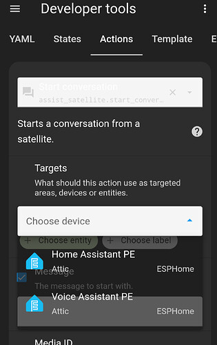

I have this working, with my own wake word, and it’s great! however, I’m noticing in Home Assistant the assist device only has “1” supported feature. I thought there should be more?
I’m also not able to get the assist_satellite.start_conversation action to work from HA over to the satellite, it says it’s not supported…

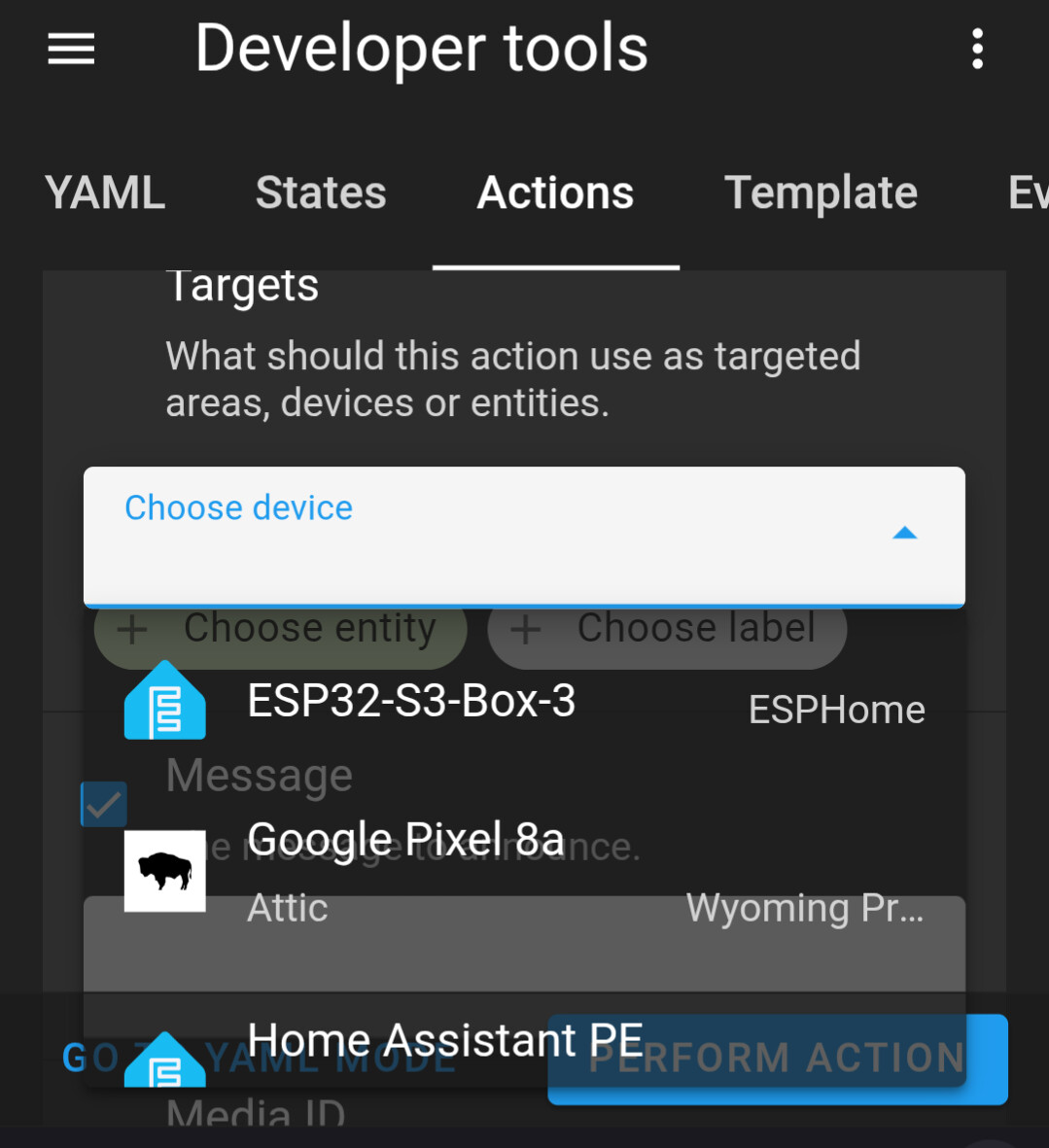

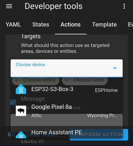

I’m pretty sure this function only works on ESP32 devices. If I choose announce all my devices pop up as I have a few Wyoming satellites but when going to dev tools and choosing the above action only my ESP32 devices show up as options so I’m pretty sure the functionality was just never added to the Wyoming Satellite integration.
