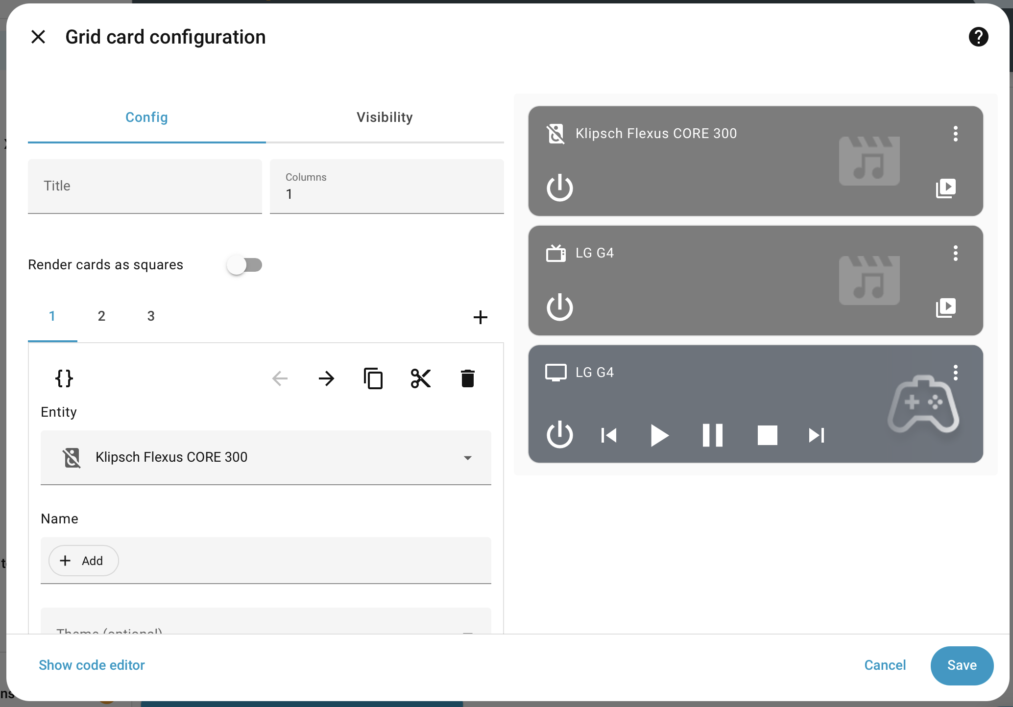

The furthest I can drill down in the editor is here:
Editing the card with Code Editor just shows YAML to make a grid. It’s the top item, “Klipsch Flexus Core 300,” that I’m interested in.

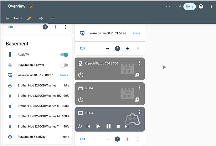

I also took a screencap of the editor for my Overview configuration in case that’s helpful:
Use the ‘Show code editor’ in the bottom left corner to get to the YAML for the whole card or the {} to see the YAML for each individual one of your 3 pieces.
That’s where you’ll find the name of the cards you’re using as well EntityIDs which are shown for each device.

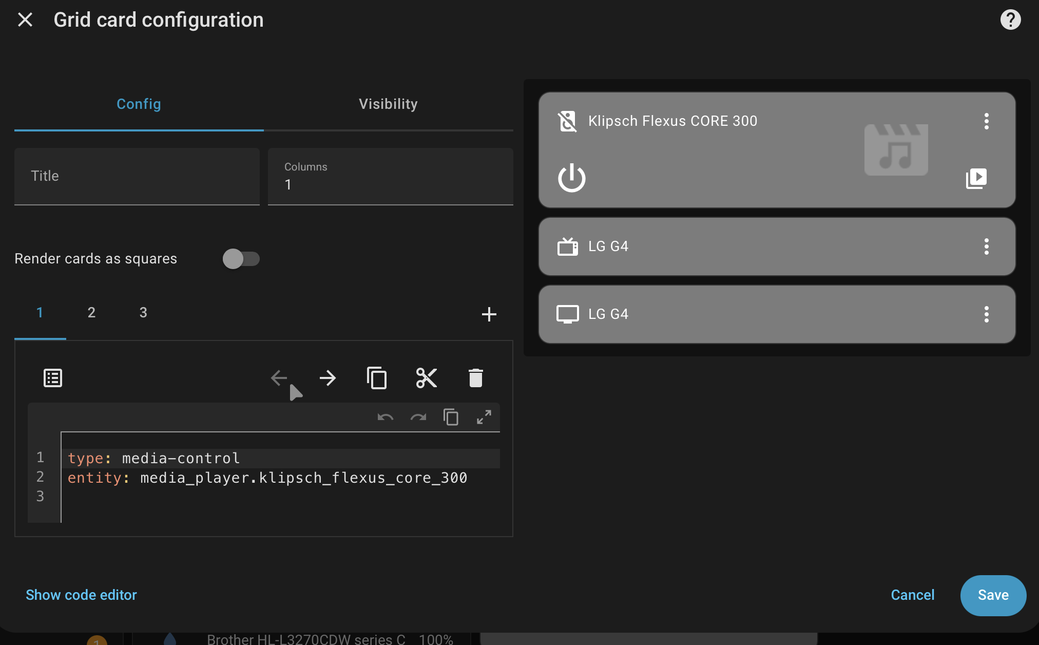

Okay. Clicking the {} was definitely a step I hadn’t taken. However, it gets me here:
It gives me the name of the entity, but not a way to see what commands it’s associated with. For example, what’s actually being sent when the power symbol on the card is clicked and the soundbar turns on/off. Is there a way I can look up the entity on my system and find more info?
