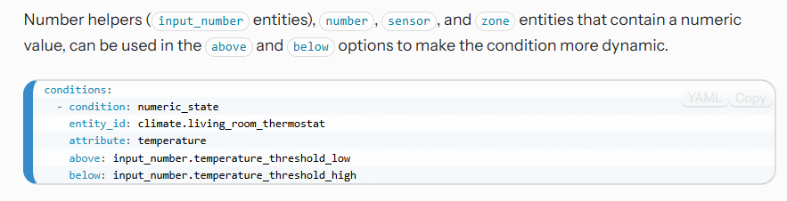

You don’t need to. If the below option supported templates the template you have would work. However below does not support templates. You can use input_numbers, but not templates:
https://www.home-assistant.io/docs/scripts/conditions/#numeric-state-condition
You would need to replace the numeric state condition with a template condition:
- condition: template
  value_template: "{{ states('sensor.front_bedroom_temperature')|float(42) < state_attr('climate.upstairs', 'target_temp_low') | float(0) }}"
