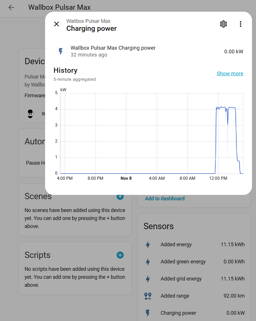

I think the wallbox reports the charging power in float, kW with 2 decimals (I added 1 minute wait just to prevent debouncing). Would a numeric_state still work in this case?

Yes it will, but I noticed I had a typo in my suggestion. It should have said above: 0 for the second trigger. Silly copy paste mistake, sorry.
I’ll have edited my post by the time you read this, and will also be changing your below value to factor in a float between 0 & 1.
