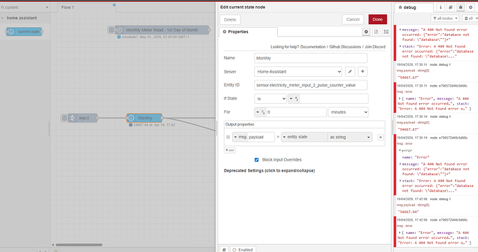

I tried 127.0.0.1 but this is the error I found:
rror
message: string
A 404 Not Found error occurred: {“error”:“database not found: "database"”}
stack: string
Error: A 404 Not Found error occurred: {“error”:“database not found: "database"”}

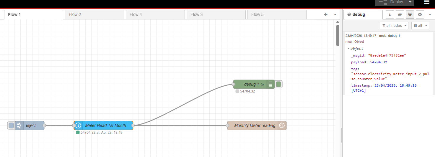

I got rid of the error messages and I am getting info from the sensor but I am confused about formatting the sensor data to get it into influxdb v1.0.
As you can see the debug info is OK and returning values, but when I look at InfluxDB explorer I see no info an the query, so I guess it is just the formatting of the info that is necessary.

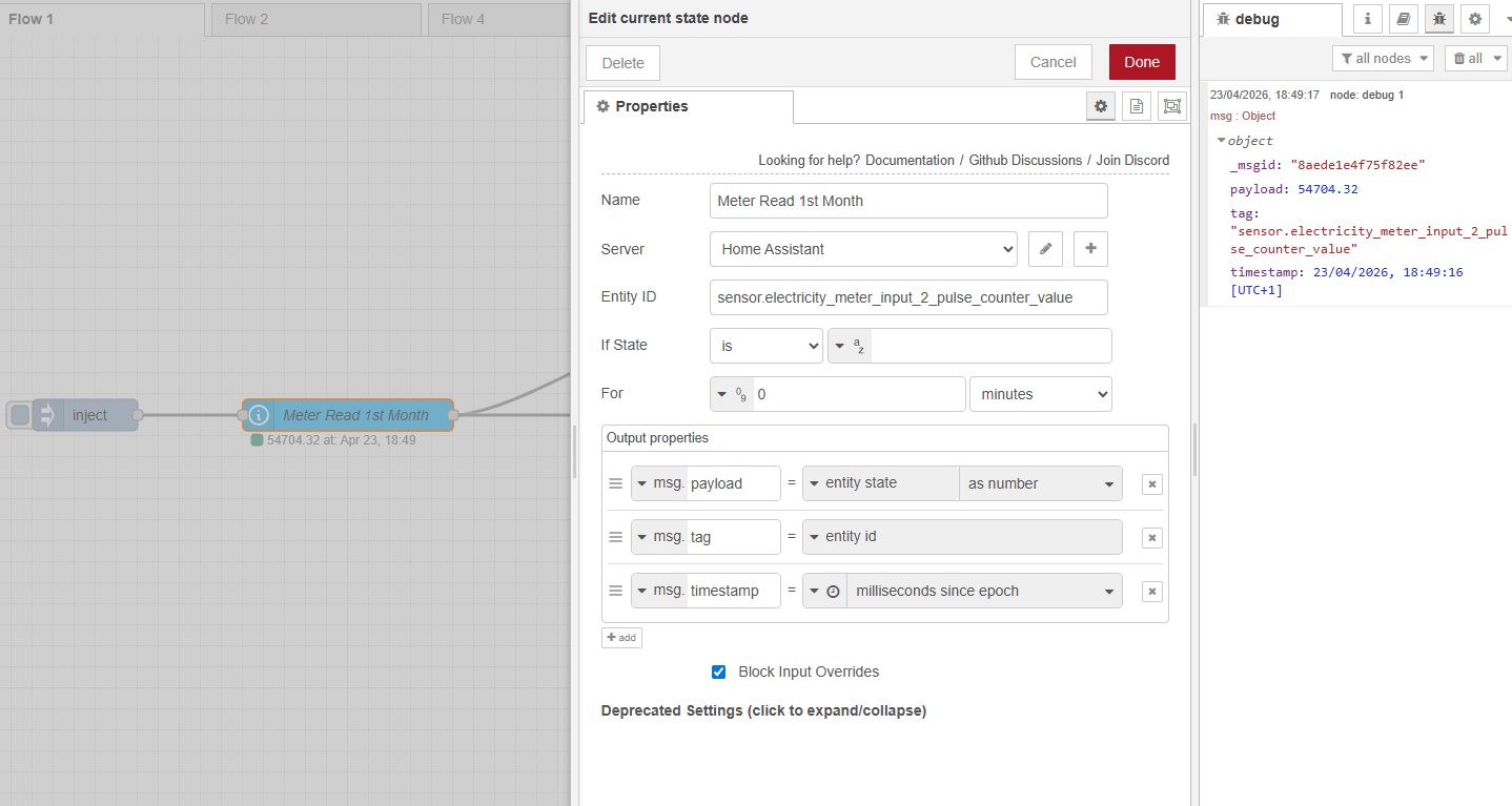

It is very embarrassing but I am really struggling with this. I have the flow working in the Node-Red but after looking at multiple YouTube tutorials and other instruction manuals on Node-red website I just cannot understand what information I need to “change” in the node to get it accepted by InfluxDB.
There is lots of info about generating this random number and that random number in JSON, but nothing for taking the reading from an actual entity and changing it to be accepted by InfluxDB.
Can someone please explain in simple language what I need to change and into what. I have very little JSON knowledge and maybe this is why I am struggling.

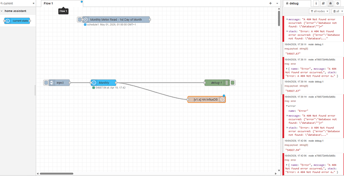

This is the current flow:

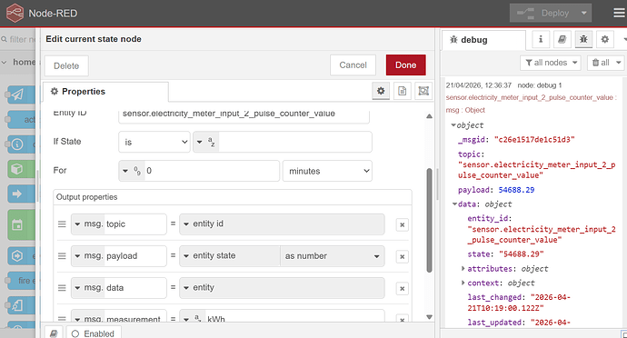

This is the expression for the current state node:
