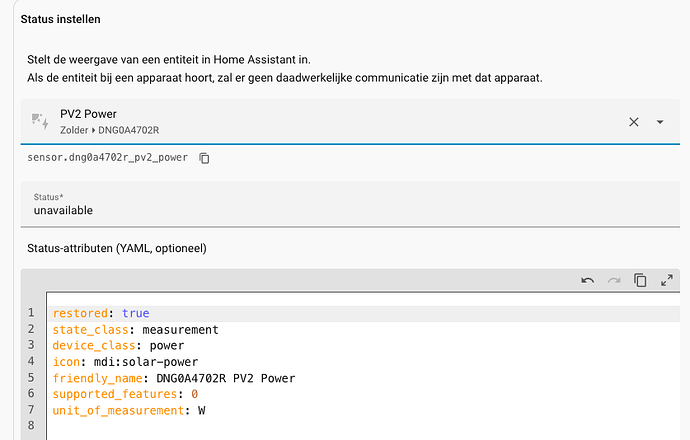

And this is a screenshot of the ‘source’ sensor
Is this enough?
