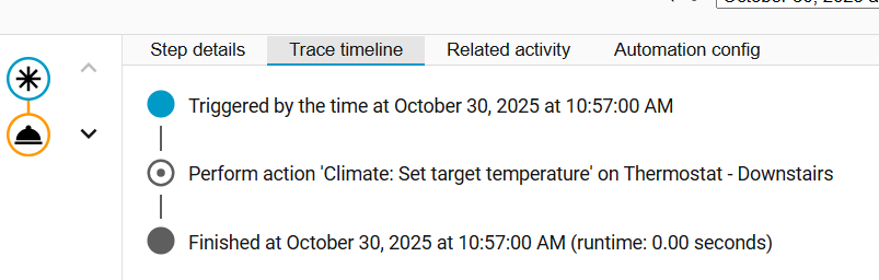

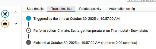

The trace looked normal (shown below) and I found no errors in the log. Also, these devices are pulled into HA by the Hubitat Integration. So I disabled the downstairs thermostat and also the thermostat controller in Hubitat, but the temperature still did not change when I ran the automation.

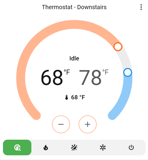

Your screen shot looks like mine. I have auto switching thermostat between heating and cooling.

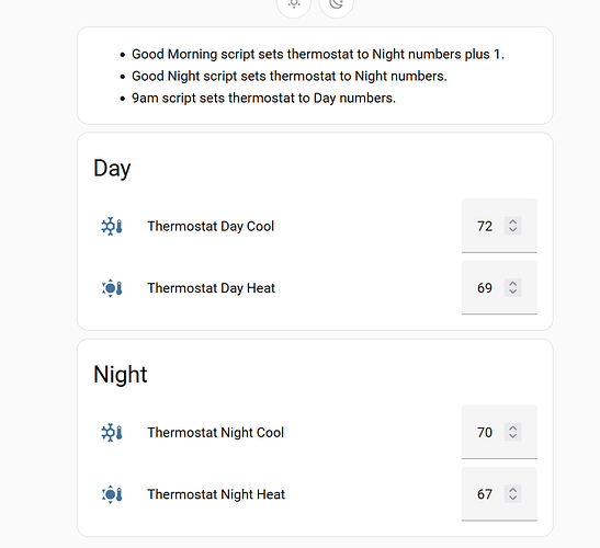

Here is my action:
      - action: climate.set_temperature
          entity_id: climate.z_wave_plus_thermostat
          target_temp_high: "{{ states.input_number.thermostat_day_cool.state | int() }}"
          target_temp_low: "{{ states.input_number.thermostat_day_heat.state | int() }}"
I am using helpers for the setting. But, should help you.
ETA:
Here are my helpers on a dashboard so the wife can make changes. It describes what my automations do with them.
