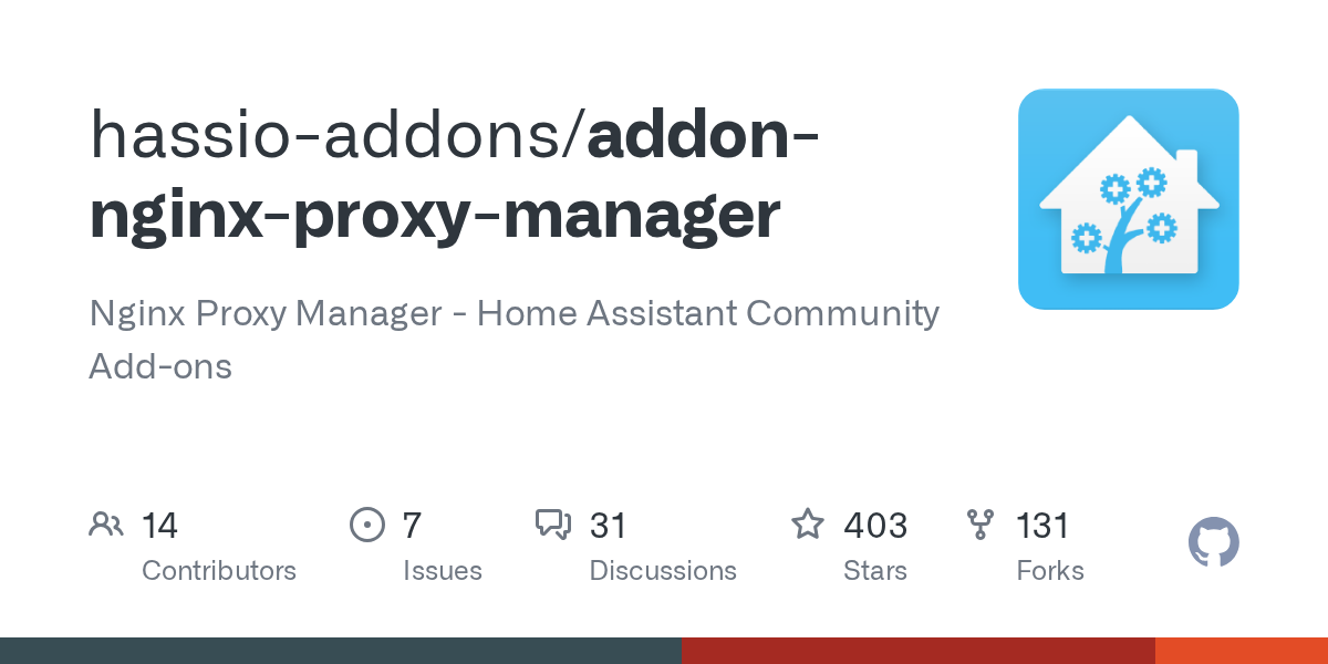

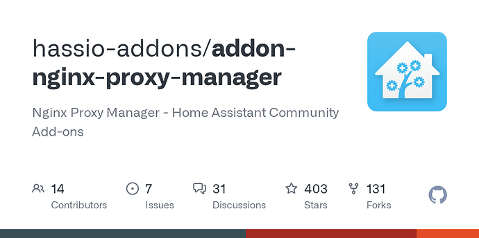

You could also use NGINX Proxy Manager addon and add Proxy Hosts incl. certificates that auto-refresh.
